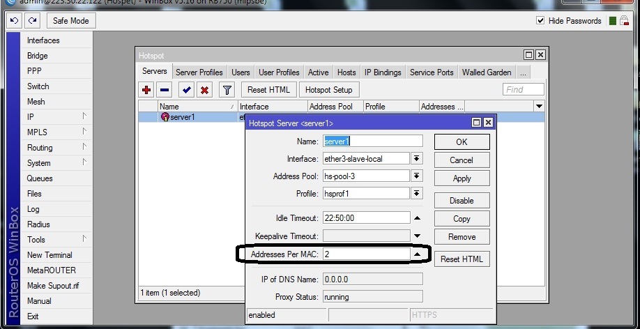

What does the column means by Addresses Per Mac?
what was use of it?
If i give any value what will happen?
any one please explain this!!!
what was use of it?
If your hotspot clients are connecting via a bridge/switch or another access point (that cannot be seen directly from the controller which may depend on the configuration and functionality of those devices), the hotspot controller may not see the mac addresses of the clients, rather that of the bridge. If you have it set to 1 and there are 10 clients behind another access point, only the first client will get an IP Address. A device can request more than one session (and IP address) for different purposes, sometimes productive, sometimes malicious. The default is usually fine for a single access point.
As per My setup Mikrotik working as a gateway after these many accees point there, so i have to keep in 2 or more than that.
As of now it has been kept 2 , so only 2 client can from the Access Point suppose if the client is trying he wont able to get IP?
it depends on how your access points are connected and configured. It would be best to test with either 1 or 2 and try to connect simultaneously 5 clients behind a single access point other than the hotspot controller and see if it works. If it doesn’t, increase the number to the amount you want. If your many access points are connected differently or are different types, you should probably test each of them.
Otherwise, leaving it at 2 is decent.
