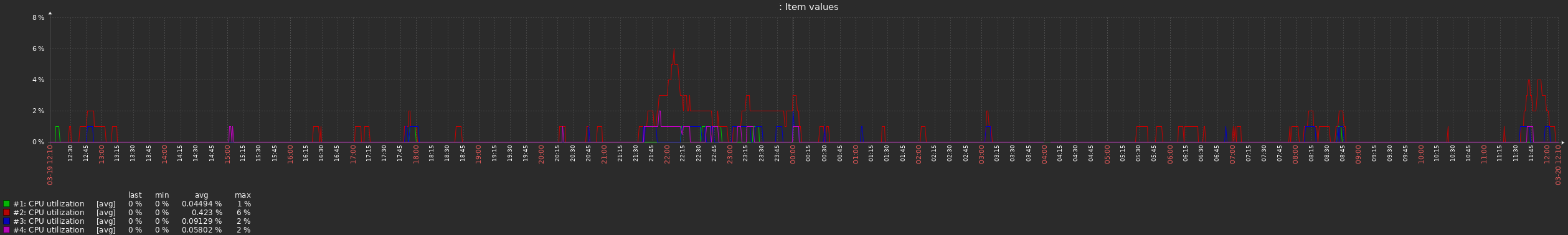

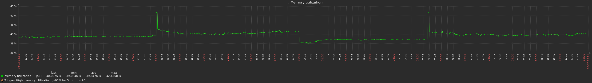

what is the cpu usage with adguard?

I’m seeing very low CPU and memory utilization.
