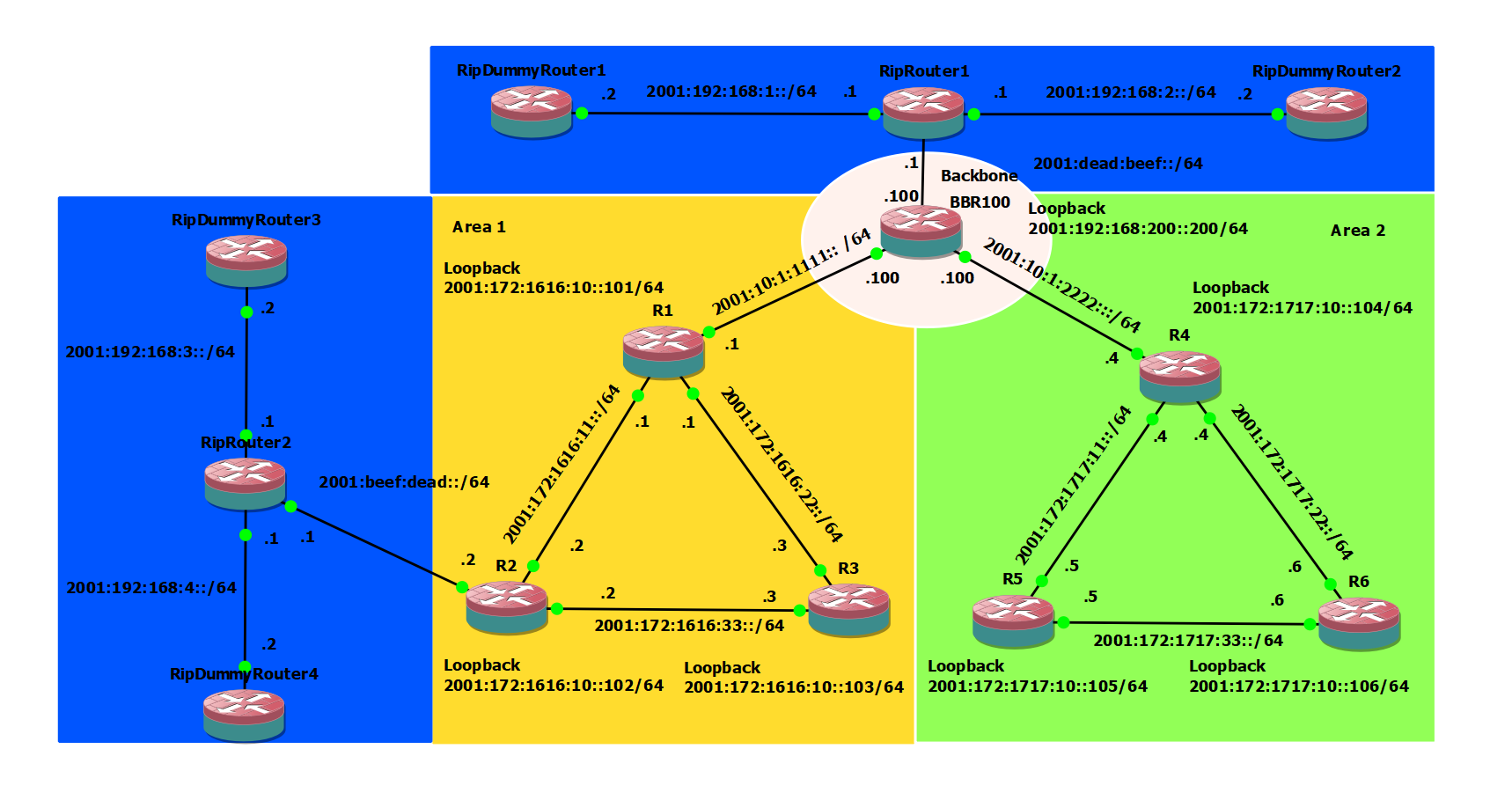

after trying, testing, googling, and wiresharking (to no avail) I finally decided to write this post in the hopes of a helping hand from someone in the community.
I’ve built a testlab with OSPF in GNS3, using MikroTiks CHR 7.11.2 (stable). Only small problems with IPv4 (again with NSSA) which I could work around, maybe I’ll post , what to me looks like a bug, in another post.
Different story with OSPFv3 though. In the following picture, you can see the topology I crafted:
In the problem scenario, Area 1 is configured as NSSA Area, which is supposed to get RIP Routes from RipRouter2 over the 2001:beef:dead::/64 net, which are then to be redistributed into OSPF via R2.
Here are the configs which I am working with:

The overarching problem is, that the LSA Type 7 routes are not saved in the OSPFv3 database and hence are not used to calculate routes. Therefore RipNet2 is not available to any router except R2.
Additionally, there are different levels to this problem:
  1. If I leave the area as “type=default” everything works, external routes get distributed, and I just lose the benefit of an NSSA.
  2. If I change the area to an NSSA (while the adjacencies are up), R1-R3 form new adjacencies (normal behaviour), receive the LSA Type 7 messages but don’t put them into the database/calculate routes (except R2). Furthermore, the LSA Type 7 packets are not translated into Type 5 by R1, so BBR100/R4/all other Routers, don’t learn about the external routes to RipNet2.
  3. If I now restart the routers, adjacency to R2 can’t be established at all, with the following errors logged by
  • R1/R3 (sequence mismatch)
  • R2 (bad lsreq)
I am at the end of my wits here. Can anybody help me figure this out?
Thanks in advance!
