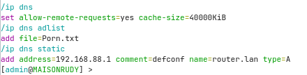

Thanks for your answer, i had done clearing browser cache, flushing mikrotik and windows dns but i got the same result.
My Adlist load properly (see image below), i set my DNS cache size to 40Mb
/ip/dns/export
