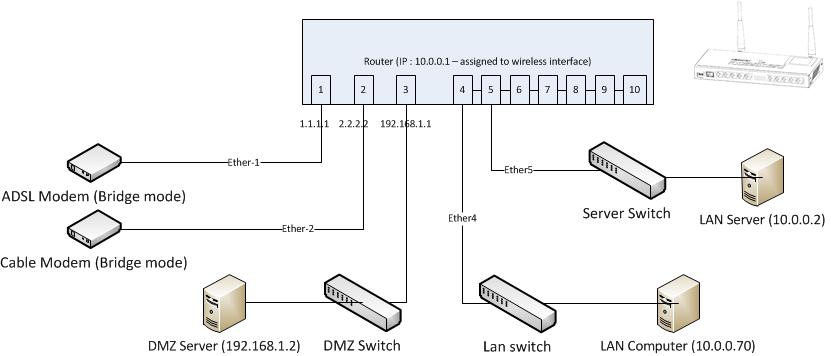

Consider the following network diagram
Everything works just fine… well almost :confused:.
Internet traffic from all my LAN clients, LAN servers and DMZ server goes out via 2.2.2.2 (DKTVWAN) just as expected. From my DMZ I can only open new connections to the internet on port 80 and 443. My LAN and LAN servers is not reachable from the DMZ server at all. From my LAN the DMZ server can only be contacted through port 3389 and port 80. Sor far so good.
But I wan’t to take advantage of both my static IP’ed internet connections for inbound traffic. The one thing I can’t get my head around is why inbound internet traffic on port 1.1.1.1 port 80 is lost somewhere on the way back from my DMZ host 192.168.1.3 (Yes it’s not 192.168.1.2 as shown in the drawing). Using Torch I can see that connections is made from src 1.1.1.1 (TDCWAN) to dest. 192.168.1.3 and my DMZ host tries to send it’s response back to the correct internet IP. Also I see connections on the IP/Firewall/Connections tab marked “OutsideConnection_TDCWAN” - so my forwarding mark-connection rules works. Also when using Torch to see if traffic originating from 1.1.1.1 is hitting the DKTVWAN (2.2.2.2) interface on the way back luckily nothing happens. So at least my connection-marks / routing-marks / routes makes sure that responses for traffic originating from 1.1.1.1 does not go out throug 2.2.2.2. But it’s lost somewhere else and i can’t figure out why or where. BTW ether4-10 + Wireless is bridged.

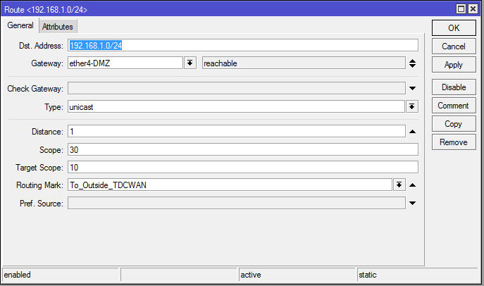

You we’re spot on. I think i just misunderstood what you meant by routing to 192.168.1.1 but it came to my mind that all these marks is just something that happens inside the router and not elsewhere. So of course the packages was lost on their way back from my host…well at least i think so. This is what I did to make it work :
I’m not sure if this is the best way to do it so feedback would be much appreciated.
Yes that was what I meant and if that has made it work then it should be a stable fix. Glad it is working!
