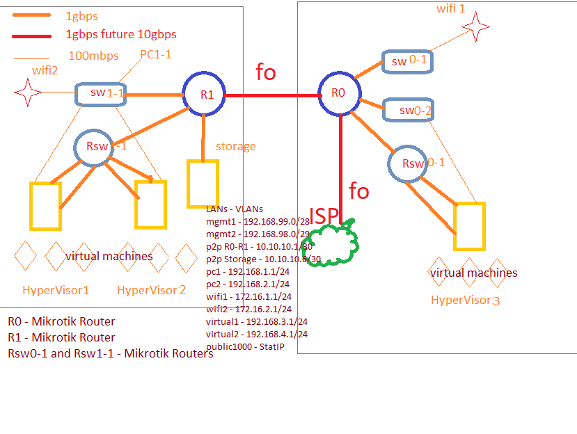

Hello to all at this forum,
First to say that this post was not wrote only to ask questions, but also to give answers and config examples.
prolog: i have one fiber connection to ISP and block of public ip address which not routed to me, but they given by dhcp server on interface - this cause first problem because i must find solution to distribute public ip to hosts in LAN (public IP to servers). I have also dedicated fiber connection between HO and BO. Internet connection is on HO. At both location i have MikroTik routers and Cisco switches. Both location has to have separated LANs with different IP range which are routed by routers. LANs has to serve for PC, WiFI1, WiFi2, VoIP, Mngmt1,Mngmt2 etc. that is the second problem And for that purpose i decide to use VLANs. Because i have OnSite (HO) Servers and OffSite (BO) Servers and because this Servers has to have public IP i need to make L2 trunks for some VLANs to pass between location - and that is third problem
To clarify:
1- i must have L2 VLAN configuration: bridge with vlans and ethernet ports in bridge
2- i must have L3 IP configuration: all IP is on vlans
3- one port at each router must have IP, and to be allowed for access - emergency local access
First configuration i succeed was have common L2 misconfiguration: couple of bridges, vlans and ethernet in bridge, eoip and vlan in second bridge, vlans on ethernet interface ect. Obviously, i change that configuration immediately.
Current configuration uses VLANs on Bridge and VLAN Bridge filtering. At IP layer to achieved connectivity between IP ranges i decide to use OSPF routing protocols.
Topology

Problems:
The problem i find here is that hw offload was not working. The problem is in fact that i have two switch chip on the RB and ports in the bridge was from both switch chip (both are 8327).
But the problem is also at R1 router which has only one switch chip (8316) where all ethernet ports are on same chip. I found that hw offload turn off at the moment when i use vlan filtering on bridge.
At Rsw0-1 and Rsw1-0 i have problems to have access to it using mgmt vlan. Also i find that RoMON don’t work.
Also, i found many problems to make things working when i choose vlans on switch cip. Trying to pair devices with different switch chips (8136 and 7240 and 8227) and that is nightmare because they don’t work at same way.
To be clear, the config i have now working, but i should improve it. Because of that i asking you folks how will you fulfill this ?
Does i have to configure all devices to use switch chips or to remain on bridge vlans on devices with router function (R0 and R1) and switch chip vlans on (Rsw0-1 and Rsw1-1) or to use bridge vlans on all devices?
Note that I expect high bandwidth demands on Rsw devices and it will be great to get maximum switch usage instead of cpu, because this device will act as switch.
Also I have to preserve RoMON function.
Finaly, i must to use all my ports on Rsw devices but also i should have one for local management as i said. To do that one port must be hybrid port (eg. ether5), that port and switch-cpu should be at the same vlan - I am unsuccessful to achieve that goal.
Note: Please don’t recommend to use another deviceses or to buy another equipment that is not reason what i write here. I need solutions with devices which i own.

add interface=bridge-vlan name=vlan60 vlan-id=60
add interface=bridge-vlan name=vlan111 vlan-id=111
add interface=bridge-vlan name=vlan999 vlan-id=999
add interface=bridge-vlan name=vlan1111 vlan-id=111
add name=dhcp_pool2 ranges=192.168.30.1-192.168.30.253
add name=dhcp_pool3 ranges=192.168.60.1-192.168.60.253
add address-pool=dhcp_pool1 authoritative=after-2sec-delay disabled=no \
    interface=ether2 name=dhcp1
add address-pool=dhcp_pool2 disabled=no interface=vlan3 name=dhcp2
add address-pool=dhcp_pool3 disabled=no interface=vlan6 name=dhcp3
add bridge=bridge-vlan ingress-filtering=yes interface=ether1 pvid=1111
add bridge=bridge-vlan frame-types=admit-only-vlan-tagged ingress-filtering=\
    yes interface=ether3 pvid=9
add bridge=bridge-vlan interface=ether4 pvid=30
/interface bridge vlan
add bridge=bridge-vlan tagged=bridge-vlan untagged=ether1 vlan-ids=1111
add bridge=bridge-vlan tagged=bridge-vlan,ether3 vlan-ids=999
add bridge=bridge-vlan tagged=bridge-vlan,ether3,ether1 untagged=ether4 \
    vlan-ids=30
add bridge=bridge-vlan tagged=bridge-vlan,ether3,ether1 vlan-ids=6
add bridge=bridge-vlan tagged=bridge-vlan,ether3 vlan-ids=111
add address=10.10.30.25/30 interface=vlan1010 network=10.10.30.24
add address=192.168.30.254/24 interface=vlan3 network=192.168.30.0
add address=192.168.60.254/24 interface=vlan6 network=192.168.60.0
add address=10.10.30.1/28 interface=vlan111 network=10.10.30.0
add address=192.168.30.0/24 dns-server=0.0.0.0 gateway=192.168.30.254
add address=192.168.60.0/24 dns-server=0.0.0.0 gateway=192.168.60.254
/routing ospf interface
add interface=vlan1111 network-type=point-to-point
add interface=vlan60 network-type=broadcast passive=yes
add interface=vlan30 network-type=broadcast passive=yes
/routing ospf network
add area=backbone network=10.10.30.0/28
add area=backbone network=10.10.30.24/30
add area=backbone network=192.168.30.0/24
add area=backbone network=192.168.60.0/24
/system identity
set name=R0
R1 config:
add ingress-filtering=yes name=bridge-vlans pvid=9 vlan-filtering=yes
set [ find default-name=ether1 ] name=ether1-t2P
set [ find default-name=ether2 ] name=ether2-t2Sw
set [ find default-name=ether3 ] name=ether3-NAS
set [ find default-name=ether4 ] name=ether4-t2Sw-Hyp
/interface vlan
add interface=bridge-vlans name=vlan050 vlan-id=50
add interface=bridge-vlans name=vlan179 vlan-id=179
add interface=bridge-vlans name=vlan188 vlan-id=188
add interface=bridge-vlans name=vlan1111 vlan-id=1111
add bridge=bridge-vlans ingress-filtering=yes interface=ether1-t2P pvid=\
    1111
add bridge=bridge-vlans frame-types=admit-only-vlan-tagged ingress-filtering=\
    yes interface=ether2-t2Sw pvid=9
    yes interface=ether4-t2Sw-Hyp pvid=9
add bridge=bridge-vlans tagged=bridge-vlans untagged=ether1-t2P vlan-ids=\
    1111
add bridge=bridge-vlans tagged=ether1-t2PTel,ether4-t2Sw-Hyp vlan-ids=\
    60,185,500
add bridge=bridge-vlans tagged=bridge-vlans,ether2-t2Sw vlan-ids=179
add bridge=bridge-vlans tagged=bridge-vlans,ether2-t2Sw,ether4-t2Sw-Hyp \
    vlan-ids=50
add bridge=bridge-vlans tagged=\
    bridge-vlans,ether1-t2P,ether2-t2Sw,ether4-t2Sw-Hyp vlan-ids=3
/interface ethernet switch vlan
add disabled=yes ports=ether1-t2P,ether2-t2Sw,ether4-t2Sw-Hyp switch=\
    switch1 vlan-id=30
add disabled=yes ports=ether2-t2Sw,ether4-t2Sw-Hyp,switch1-cpu switch=switch1 \
    vlan-id=50
add disabled=yes ports=ether1-t2P,ether4-t2Sw-Hyp switch=switch1 vlan-id=60
add disabled=yes ports=ether2-t2Sw switch=switch1 vlan-id=179
add disabled=yes ports=ether1-t2P,ether2-t2Sw switch=switch1 vlan-id=188
add disabled=yes ports=ether1-t2P,ether4-t2Sw-Hyp switch=switch1 vlan-id=\
    185
add disabled=yes ports=ether1-t2PTel,ether4-t2Sw-Hyp switch=switch1 vlan-id=\
    500
add disabled=yes ports=ether1-t2PTel,switch1-cpu switch=switch1 vlan-id=1111
add address=10.10.30.17/29 interface=vlan05 network=10.10.30.16
add address=192.168.179.1/24 interface=vlan179 network=192.168.179.0
add address=192.168.188.1/24 interface=vlan188 network=192.168.188.0
add address=10.10.30.26/30 interface=vlan1010 network=10.10.30.24
add address=10.10.30.29/30 interface=ether3-NAS network=10.10.30.28
add interface=vlan188 network-type=broadcast passive=yes
add interface=vlan179 network-type=broadcast passive=yes
add area=backbone network=10.10.30.16/29
add area=backbone network=192.168.188.0/24
add area=backbone network=192.168.179.0/24
/system identity
set name=R1
config Rsw1-1:
add ingress-filtering=yes name=bridge1 pvid=9 vlan-filtering=yes
set [ find default-name=ether1 ] name=ether1-trunk
set [ find default-name=ether2 ] name=ether2-v185
set [ find default-name=ether3 ] name=ether3-v185
set [ find default-name=ether4 ] name=ether4-trunk
set [ find default-name=ether5 ] name=ether5-trunk
/interface vlan
add interface=bridge1 name=vlan05 vlan-id=50
add bridge=bridge1 interface=ether1-trunk
add bridge=bridge1 frame-types=admit-only-untagged-and-priority-tagged \
    ingress-filtering=yes interface=ether2-v185 pvid=185
    ingress-filtering=yes interface=ether3-v185 pvid=185
add bridge=bridge1 interface=ether4-trunk
add bridge=bridge1 interface=ether5-trunk
add bridge=bridge1 tagged=bridge1,ether1-trunk vlan-ids=50
add bridge=bridge1 tagged=ether1-trunk untagged=ether2-v185,ether3-v185 \
    vlan-ids=185
add bridge=bridge1 tagged=ether1-trunk,ether4-trunk,ether5-trunk vlan-ids=\
    30,60,500
add address=10.10.30.22/29 interface=vlan050 network=10.10.30.16
add distance=1 gateway=10.10.30.17
/system identity
set name=SW-Hyp-NOC
If the performance of the vlan-aware bridges is sufficient the leave things as they are, otherwise you could look at converting some to use hardware switching.
As mentioned previously hardware switching with hybrid ports is supported only by some gigabit switch chips (QCA8337, Atheros8327), it is not possible with the other gigabit switch chips (Atheros8316, MT7621, RTL8367) or any of the fast (10/100) switch chips.
