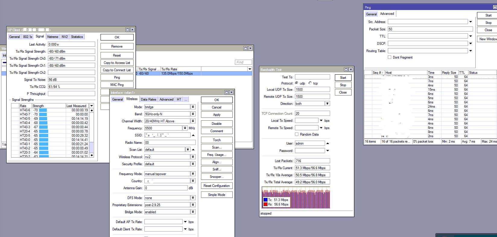

The situation is as follows:
LoS 12 km, one side 130 meters above sea level, other 400.
Two yirous jrc-29 duplex antenna, Rb433GL with R52Hn, other side Rb711-5Hnd.
No other 5Ghz radio around.
Picture attached for more info…
Can I achieve better results?
Tnx.

of course throughput, isn’t it typically imperative for all PtP links? :wink:
The problem is certainly in signal.
Pigtails and cards checked, i play with ch0 and ch2 and hor. vert. combination:
If on one side ch0 is vert. polarization and ch1 hor. polarization that’s mean that on other side the combination must be the same or it is unimportant?
Yes, polarity selections need to be the same on both sides. If your ch1 is where you are experiencing problems, try changing polarities/frequencies. Your original post said that there were no other 5.8 GHz radios around, but you would not be experiencing the signal loss you are without some kind of interference and/or a bad configuration. Especially since your other channel looks fine.

Now I got better throughput, 50/110 Mbps at 12 km.
But can someone explain meaning of the signal strength for ch0 and ch1
Tx/Rx signal strength Ch0: -79/-66 dBm
Tx/Rx signal strength Ch1: -58/-57 dBm
What mean Tx what Rx signal strength ex. Ch0 if one pol. antenna on other side can see only the same pol antenna at the other side..
In my case I cant get bether Tx signal strength on Ch0 (-79 dBm) ???
Essentially your Tx/Rx is your transmit/receive power levels. So if your ch0 is -79/-66 dBm, that means you are transmitting at -79 dBm (the power level the other end receives) and receiving at -66 (the power level received from the other end) dBm. Average noise levels in the 5.8 GHz spectrum are about -90 to -96 dBm, unless you are near a major metropolitan area, in which case they could be higher. You want to aim for the low 70’s at a minimum for PtP links. If you don’t get to the low 70’s you will experience dropped packets and degraded throughput.
