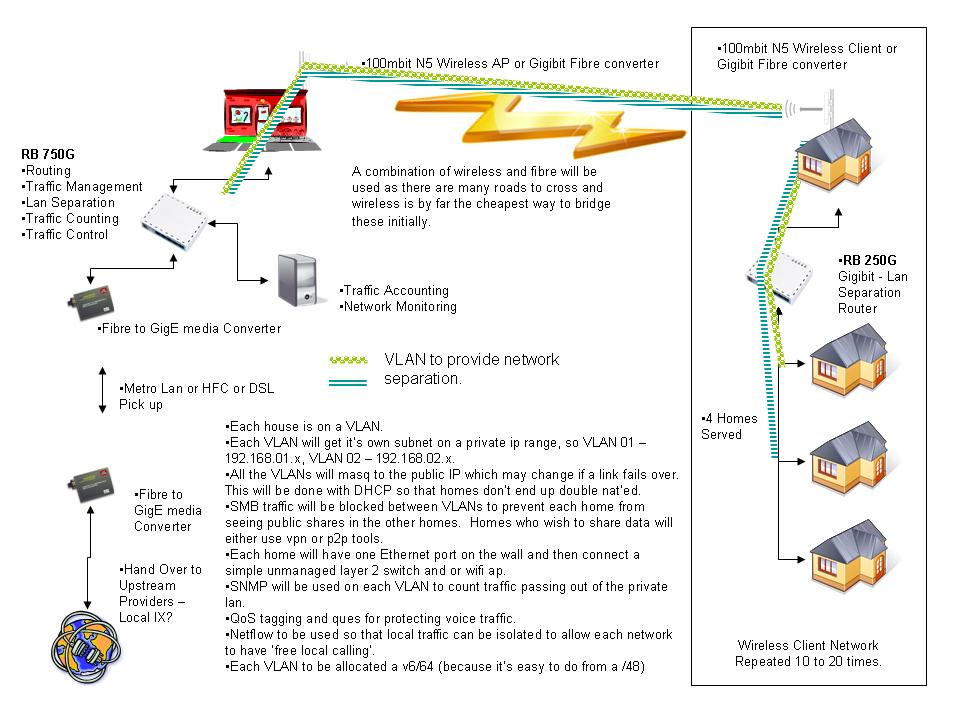

Network Concept
Here’s my concept. I’m not planing ppp at all because that would require a router at the customer end and I don’t get the value in that if I can just do what I want to with vlans.
Personally I’ve only just got a RB 750G and I’m just learning to use it, so I’m setting it up as a basic SOHO router first just to learn each unit that I need to know about (QoS, VLAN, DHCP, etc) but the picture above shows the dream.
