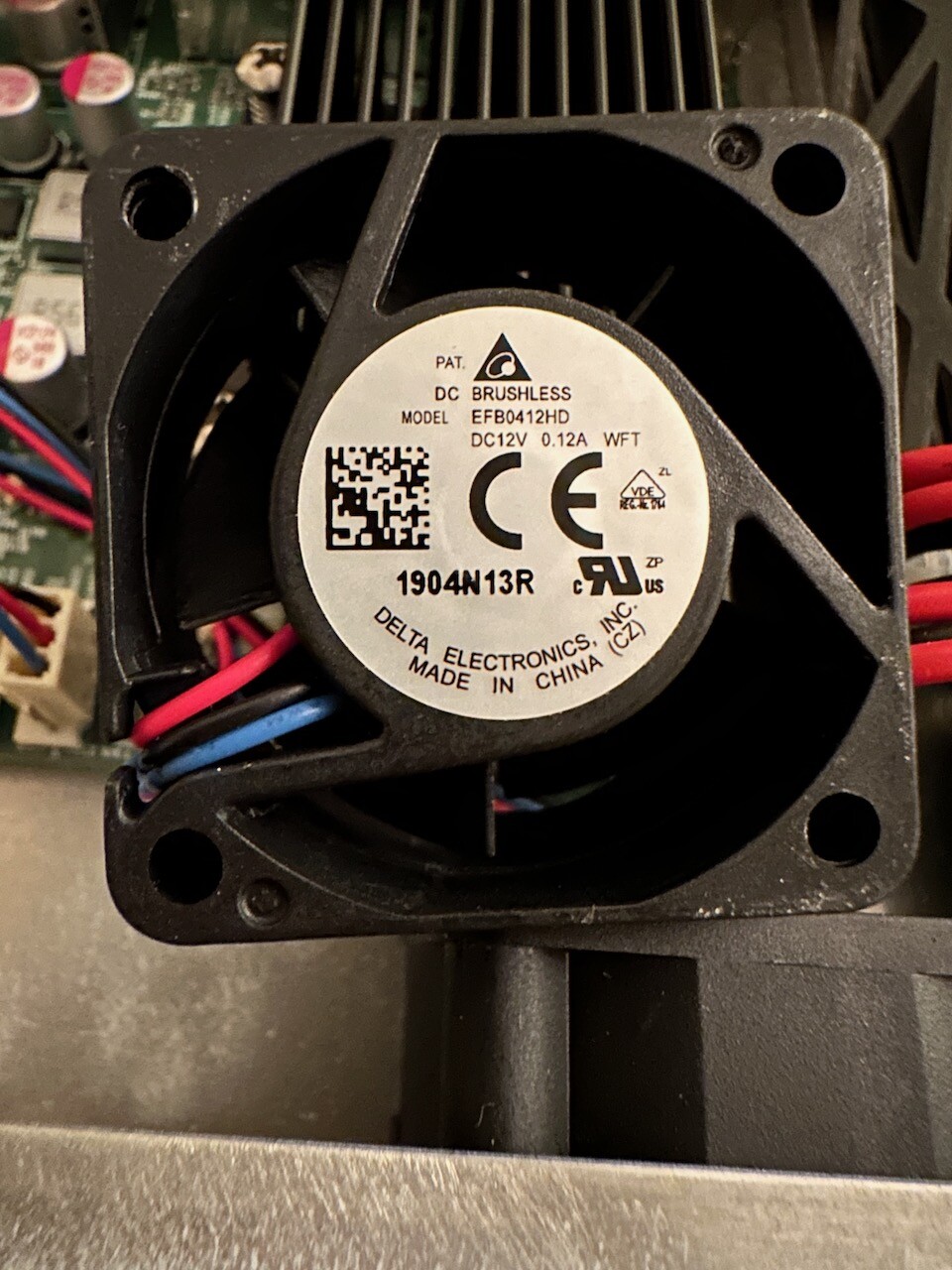

Hi, I have recently acquired a CRS510-8XS-2XQ-IN switch. The 2 fans on the switch are a little loud for in-home use. I have taken pictures of the fans in the device (attached to this post).
The original fans on the device seem to be this one: https://www.digikey.ee/en/products/detail/delta-electronics/EFB0412HD-F00/2560520
  • Dimensions: 40x40x20 mm
  • Wires: 3-pin
  • 12V, 0.12A
  • RPM: 7600 RPM
  • Air Flow: 8.54CFM (14.52 m3/h)

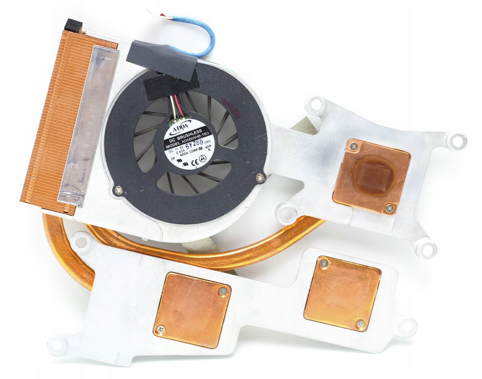

Just thinking the DIY way … laptop’s radiators are very thin so they can fit horizontally in the chasis so mount it on SFP elements and let the fan cool the ASIC radiator. Any recycled radiator could be used but the more thermal pads you have to apply to SFP cages, the better.
