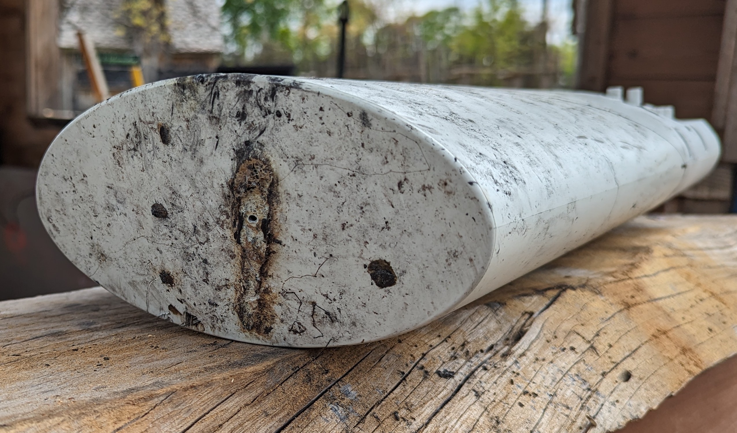

I am nervous about the Pro Cubes. Couple posts about water getting in them.
The old cubes didn’t seem to have the issue.
I got a pair and I can see where I would want to put silicone around a few edges.
Yes freezing and thawing does wonders on ill constructed outdoor equip.
A burning roof took this one out. Actually it was when the fire was being put out. Something finally made that small hole in the top.
