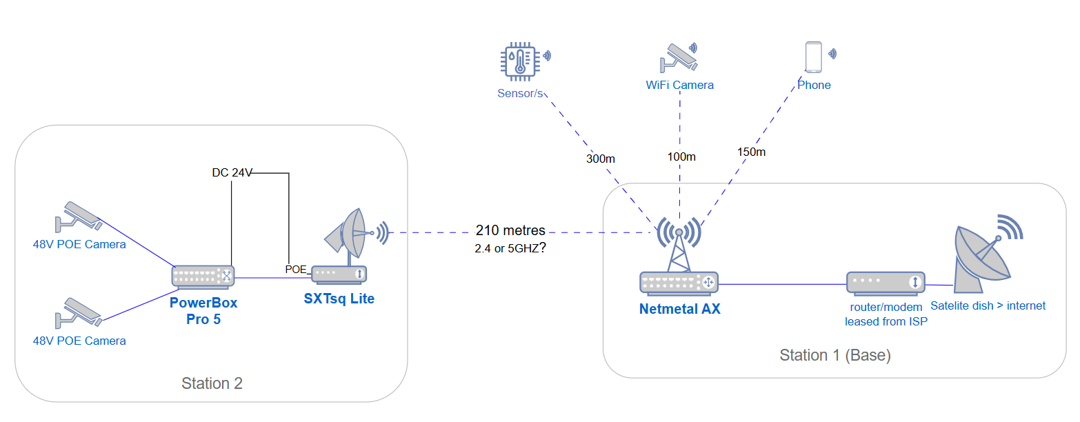

I have included a network diagram as a quick example.
The longer description below the image details the environment, my expectations for each device, and specific questions.
Station 1 (base):
Location: The base station let's call it "Home" is on a knoll in the middle of the property. There is an antenna pole on the roof, able to get the base antennae several meters above the roof. There are patches of thick trees in most directions but the raised antenna has a view of the whole area. Standard AC power is available at this site so any adaptor can be used. We already have an old 2.4Ghz b/g/n Belkin router set up as an access point, which provides patchy service within 100m up to 180m max. We have signal reaching to within 20m of station 2 using this old router.
For station 1, I intend to purchase the NetMetal AX with 2x HGO-antenna-OUT omni antennae.
  • I might instead get a L23UGSR-5HaxD2HaxD (I believe it is the same device as Netmetal but without the case?)
The netmetal will be set as an access point and connected to the LAN of our internet provider's lease router.
My expectations of the Netmetal:
  • It will provide Wifi access to multiple end user devices such as phones and wifi cameras within a roughly 300m radius, with reasonable limitation expected due to patchy tree coverage.
  • It will provide a wifi bridge to a remote station with an SXTsq Lite at 210 metres distance, with one row of thin trees in between.
Are these expectations realistic?
Questions:
  • Is the NetMetal with HGO omni antennas capable of coverage to 200-300 metres line of sight? Or should I use multiple directional antennas?
  • Would I need a directional antenna to make the bridge connection?
  • Would I be better off buying the bare router board L23UGSR-5HaxD2HaxD? it's the same board as NetMetal without the case and has 4 MMCX connectors instead of 2 SMA. I already have an old routerboard case that fits, it could be well worthwhile to save some cost on the Netmetal. I would keep it indoors and run coax a few metres up the pole anyway.
Station 2:
Located 210m uphill from station 1. There is a direct view but one row of thin trees in between.
This site should be able to provide a stable connection to probably 2 POE cameras, maybe more or some sensors as well. Cameras need to be of good resolution, and I'd like them to be able to connect to the WiFi internet in the normal way for these new-fangled cameras so I can watch them from in town on a cell phone as well as anywhere on the local network.
For this location I intend to purchase 2 devices: a Mikrotik SXTsq Lite, either 5g or 2g, and a Powerbox Pro 5.
My expectations of the SXTsq Lite:
  • It will run on 12-24V via the DC plug on a POE injector.
  • It will create a wifi bridge with the NetMetal device at station 1.
Question: Should I get the 2.4ghz or the 5ghz version of SXTsq Lite for this distance and the trees??
My expectations of the Powerbox Pro:
  • It will run on 12-24V DC via the DC input plug.
  • It will output 48V POE on all 4 LAN ports.
  • It will connect via ethernet cable to the SXTsq Lite and share the home wifi connection from station 1 with up to 4 POE cameras or other devices.
Question: is it correct that I can give the Powerbox Pro low voltage 12 or 24v dc, and it will still output standardised 48V POE? Meaning it has a voltage booster inside?
~ Thankyou for reading ~
I know it was long, but hope to have given enough useful details to help you to help me :smiley:
