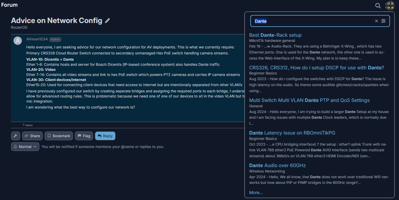

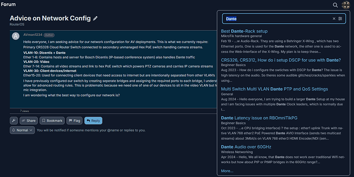

Hello everyone, I am seeking advice for our network configuration for AV deployments. This is what we currently require:
Primary CRS328 Cloud Router Switch connected to secondary unmanaged Hex PoE switch handling camera streams.
VLAN-10: Dicentis + Dante
Ether 1-6: Contains hosts and server for Bosch Dicentis (IP-based conference system) also handles Dante traffic
VLAN-20: Video
Ether 7-14: Contains all video streams and link to hex PoE switch which powers PTZ cameras and carries IP camera streams
VLAN-30: Client devices/internet
Ether15-20: Used for connecting client devices that need access to internet but are intentionally separated from other VLAN’s
I have previously configured our switch by creating seperate bridges and assigning the required ports to each bridge, I understand that this method is crude and does not allow for advanced routing rules. This is problematic because we need one of one of our devices to sit in the video VLAN but have access to the Dicentis VLAN for camera + mic integration.
I am wondering what the best way to configure our network is?
