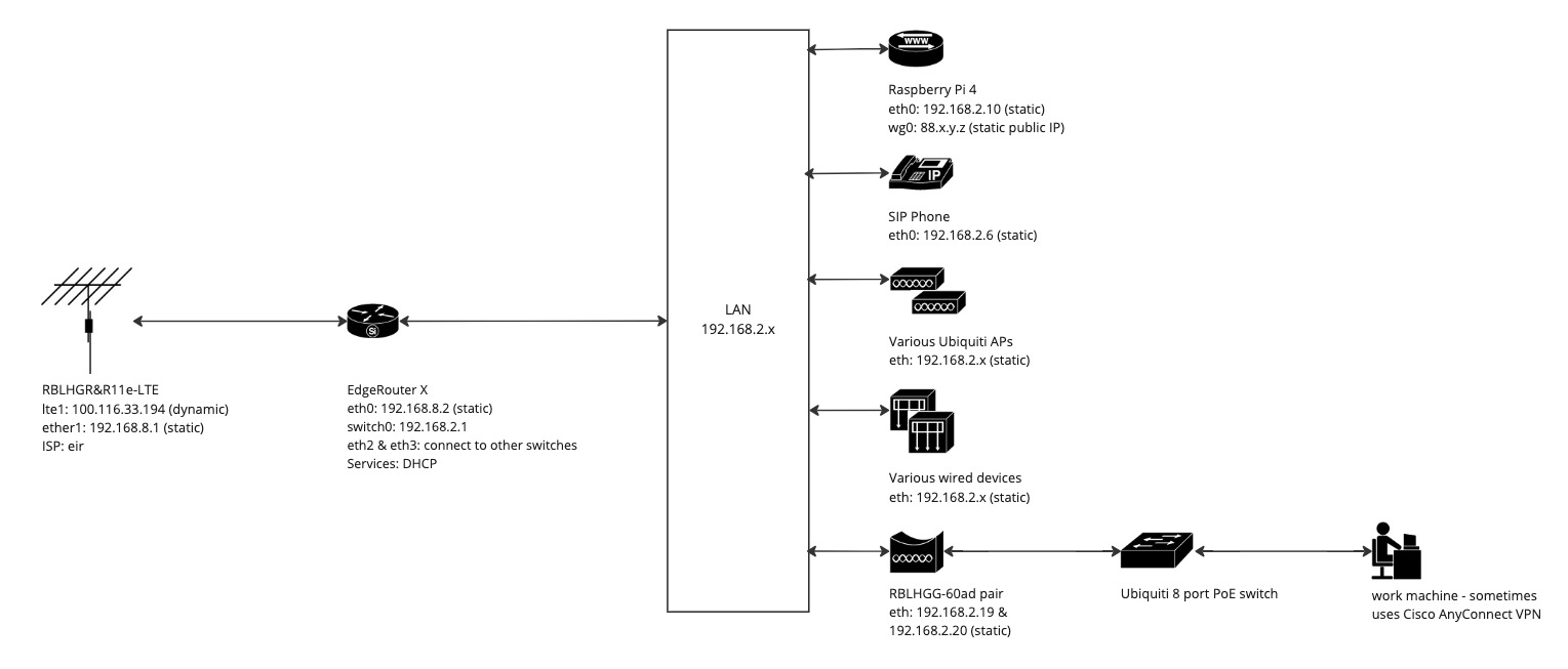

This is a high level view of what my network looks like today. There are likely things that could’ve been done better but it all seems to work :slight_smile: . There’s a mix of mostly Ubiquiti and Mikrotik kit in use for the network.
