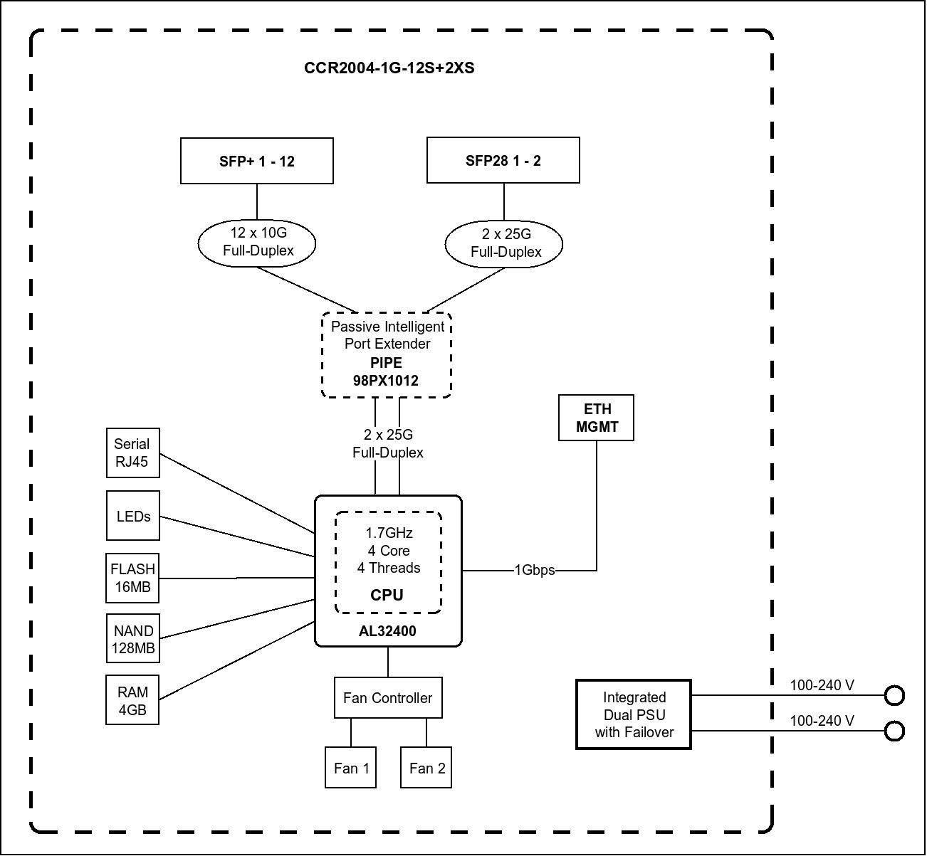

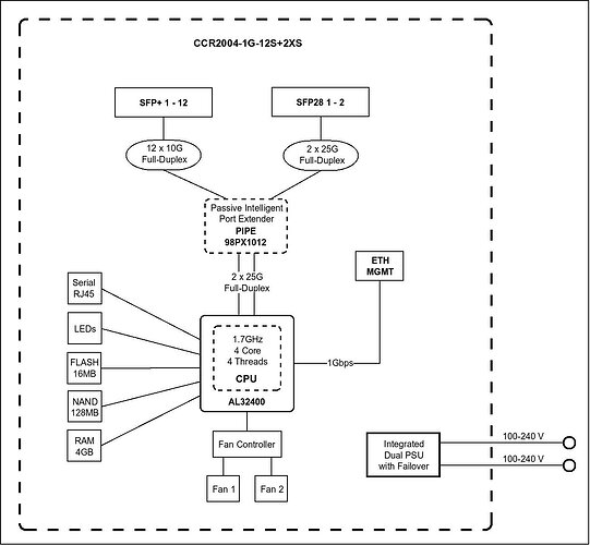

looking at block diagram of that ccr2004 reference we can see that trying to take advantage of so many interfaces can consume more resources than doing it with a switch
