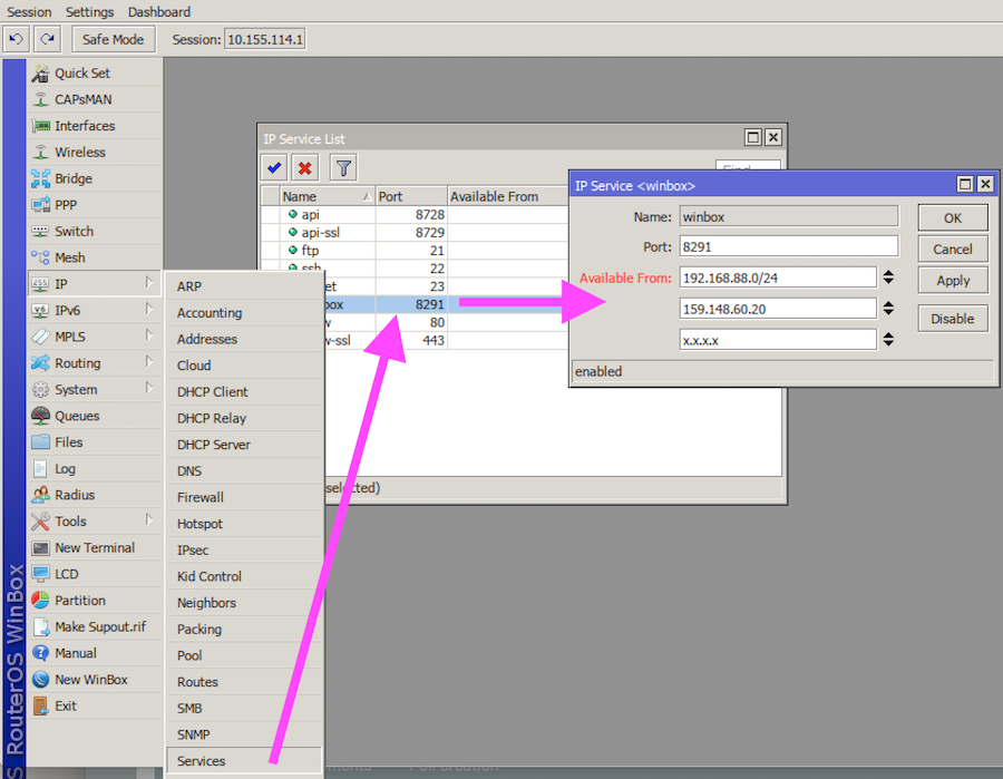

What do do: 1) Firewall the Winbox port from the public interface, and from untrusted networks. It is best, if you only allow known IP addresses to connect to your router to any services, not just Winbox. We suggest this to become common practice. As an alternative, possibly easier, use the “IP → Services” menu to specify “Allowed From” addresses. Include your LAN, and the public IP that you will be accessing the device from. 2) Change your passwords.
What to expect in the coming hours/days: Updated RouterOS versions coming ASAP. RouterOS user database security will be hardened, and deciphering will no longer be possible in the same manner.
EXAMPLE how to protect yourself:

The problem with allow from is that not always we have static ip address
Suggestions could be that field accept dns names, or allow to read from addressing list

@raffav If you are not using static IP’s, use something like DYNDNS to set up aliases. Then, resolve the aliases in a script which will give you the IP addresses of the remote stations which are permitted access. Add these to the list of allowed IP’s (Available From field in picture) and you have solved the problem.
Normis, it seems this not help.
