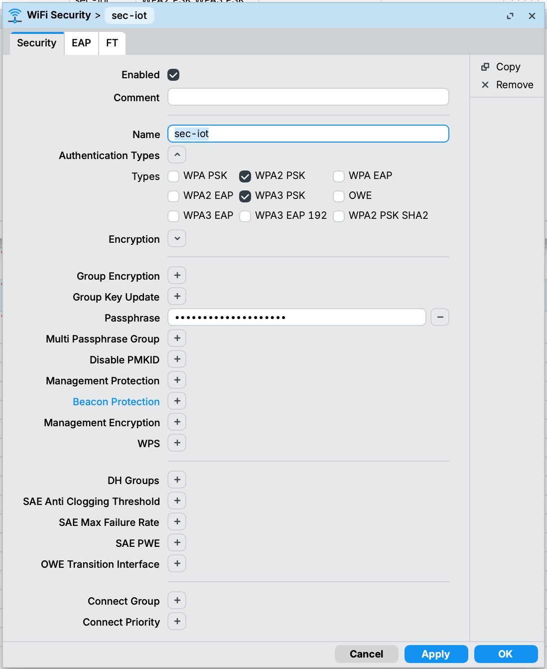

Thanks for the feedback. Some curious things:
I didn't set the security.multi-passphrase-group="" and there's nothing in the Winbox UI to indicate that there's anything set on that value (WB 4.1 on MacOS)
On the channel.deprioritize-unii-3-4=no, I've set that to yes (although you'd think that this is the sort of thing that would get set by selecting the country value). Good call.
No idea why WB added tx-power=0. Looks like a slip of the mouse since it was visible in the UI. Again, nice catch.
