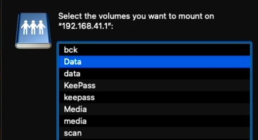

I just tried my 2008 Mac Pro 3.1 with 15.3.2 and i noticed the following:
All my shares seems to have been duplicated with caps and without.

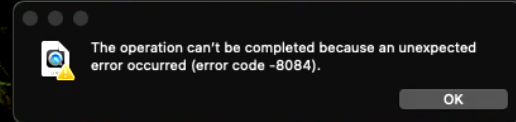

EDIT: i got one interesting thing.
It wont let me copy any file from the share
Through terminal seems to work tho. Weird thing
