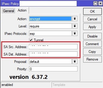

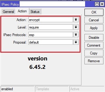

Hello everyone,
I have 2 router and need to join by IPSEC between them, So when i need to finish all step before the last one i cant see :
SA Src. Address
SA Dst. Address
In ip>ipsec>policies>Action
And you can see the result in photos below:
But in ver. 6.37.2 :
SA Src. Address
SA Dst. Address
Include that.
Where can i find this in ver. 6.45.2
THANKS
SA Src/Dst Address was where you put the same addresses as in peer config. Now you select peer on General tab and they are taken from there automatically.

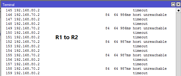

You get timeout on phase 1, so first thing to check out is connectivity between 192.168.80.2 and 192.168.70.2. Can they reach each other? Doesn’t firewall block port 500? Can you ping between those addresses (if you don’t block ping with firewall)?
I tested to ping from new termainal by 2 routers
router 1>ping 192.168.80.2 or 192.168.80.1 the result timeout or host unreachable
note that i connected the tunnel direct by utp cable from router 1 to router 2 by (ether 1) in 2 In both cases.

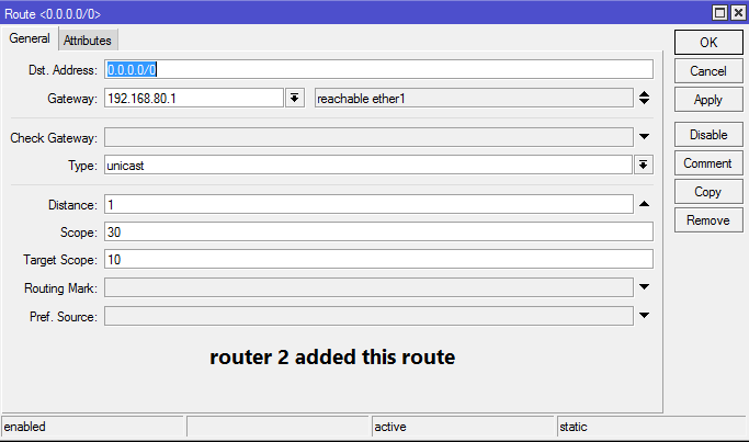

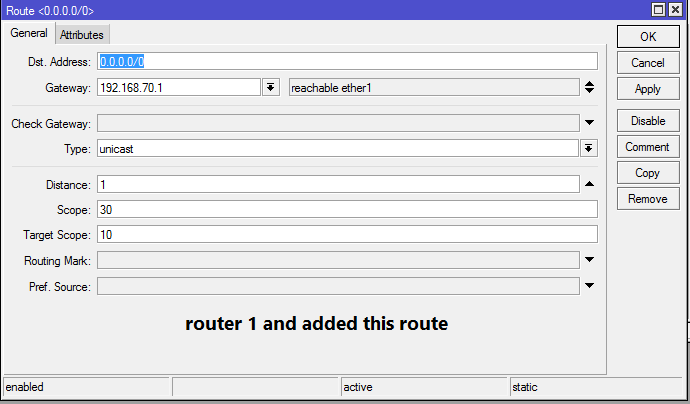

So i added the static route in both router and show below:
and the rule firewall added in 2 routers:
in this time i can’t ping by 2 routers from 192.168.80.2/30 and 192.168.70.2/30!
how can solve the big problem.
THANKS

If you have direct connection between ether1 on first router and ether1 on second, it can’t work like this, because there’s no routing between them. You added routes, but there’s no 192.168.80.1 or 192.168.70.1 anywhere.
You need to have same subnet on both ether1s, e.g. 192.168.70.1/30 on one router and 192.168.70.2/30 on the other. Then use these addresses for remote peers and it will connects. BUT such config is not good for testing IPSec tunnels, because traffic between internal subnets will flow even when tunnel doesn’t establish. You’d need to do extra config changes to prevent that, but it could interfere with your testing.
It’s better to put third router in the middle to simulate internet. Keep your current addresses and add 192.168.80.1/30 and 192.168.70.1/30 to interfaces on this third device. Then either block routing between those internal subnet, or just don’t add any routes at all and it will have the same effect.
