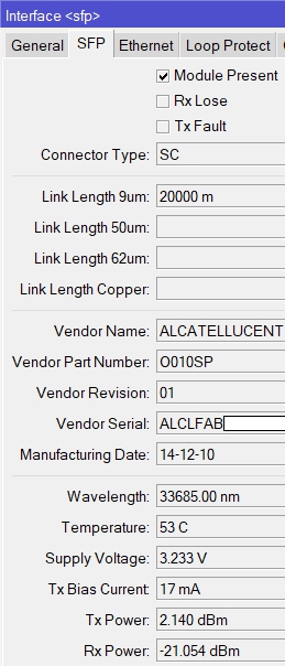

Hello, I am attempting to use an Alcatel G-010S-P ONT SFP GPON on my CRS328-24P-4S+ switch. This will be used to connect to a Bell Canada FTTH service. The issue I am seeing is that I can see my packets being sent but nothing is being received. Looking at the status of the SFP module something that strikes me as odd is the wavelength. This should be 1310nm or 1490nm from my understanding yet it is listing 33685.00nm.
I am wondering if this could simply be a defective module or if there may be something else wrong. I know that the FTTH service is working because when I use the provided Alcatel G-440G-A ONT, which unfortunately has a soldered down built in GPON, it is working.
This odd wavelength appears as soon as the module is inserted regardless of whether or not the fiber strand is physically connected.

Yes, it was either a bad SFP, or an incompatible one. I ordered a variant of the same Nokia (Alcatel-Lucent) SFP, with model O-010S-P which from what I could tell was just a model that had higher operating temperature limits. As soon as I installed this module, the link came up immediately when forced to 1Gbps with auto-negotiation disabled. Strangely, although the service is working, RouterOS still reports the wavelength as 33685.00nm when I know for a fact that GPON operates at 1490nm for download traffic and 1310 for upstream traffic. So, I don’t know if this is just a bug in the driver or something else, but, it works.
