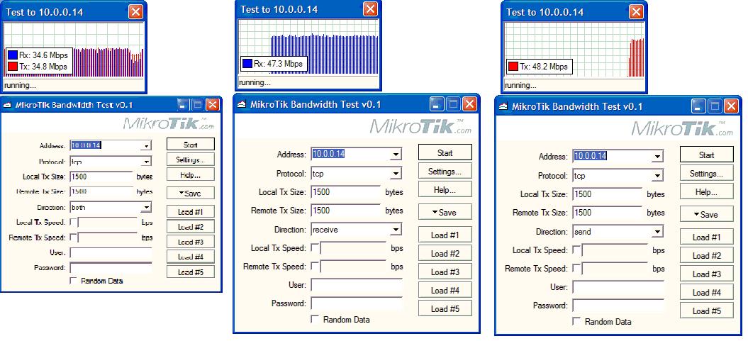

My new test proves to be alot more promising. I have a new test setup using ARC5823P panel antennas at each end of the nstreme point. Test was done using RB433AH w/2xR5H and RB600 w/2xR52H connected to the panel antennas. I have framer policy set to none in this test, using turbo mode and frequencies 5290 and 5760.
The speeds from the test.
2 way throughput averages 25-30Mbps pc - pc.
1 way throughput averages 46-50Mbps.
TCP traffic flowing through nstreme.
I am going to do the same test on the ALIX board with the XR5s and see what the throughput is.
