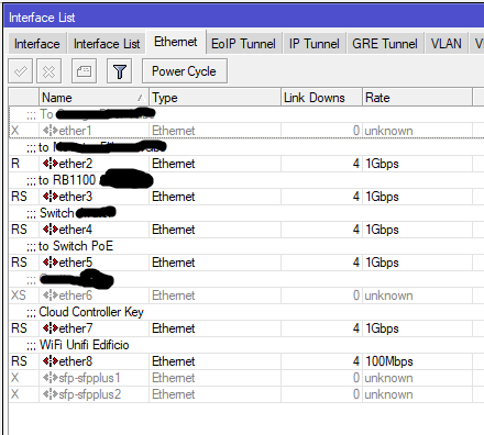

This is my interface setup, all Gigabit except one that goes 100mbs
no luck… :frowning:
