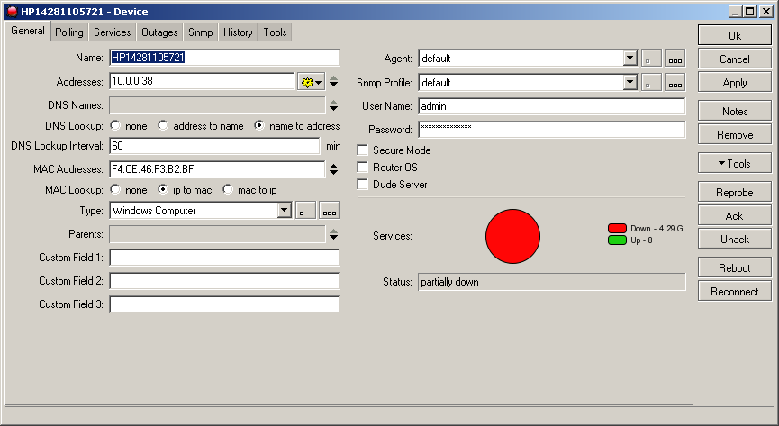

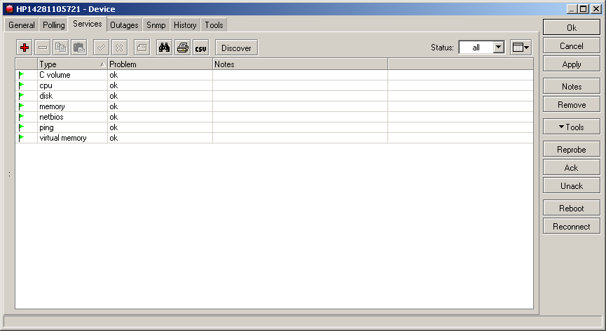

can someone explain to me why my computer in the map is orange while all probes are in “ok” state? What is this “Down - 4.29 G”? See the attached images.
I have The Dude v4.0beta2.
Pavel

Select your device, click remove, click undo.
There was an SNMP bug that would try to add a whole lot of non-discovered-probes to your device. This is gone in 4.0b2.
Yep, that worked. Weird issue. Thanks a lot.
BTW, it’s not gone in v4.0b2 - I have this version as I stated in my first post. ![]()
Oh wow, well I thought it was. I have not seen it for a long time. At least the work around is easy…
