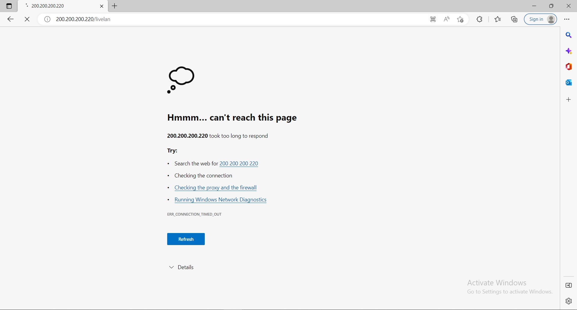

Note: currently when I try to access it via any user in the network, message “connection was reset” is appearing.

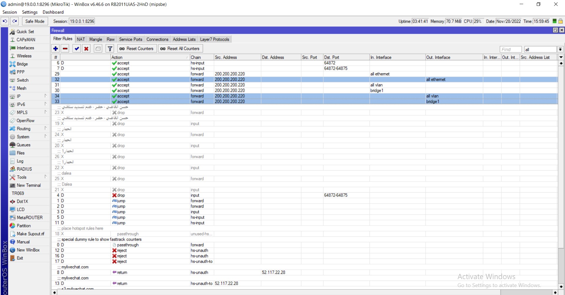

add chain=forward action=accept in-interface-list=LAN out-interface=vlan10 dst-address= 192.168.10.55
I did everything possible to allow access to this pc but unfortunately, the page is timed out. I have no idea why?
e.g.
add chain=forward action=accept in-interface-list=all vlans out-interface=ether9 dst-address=200.200.200.220
add chain=forward action=accept in-interface-list=bridge1 out-interface=ether9 dst-address=200.200.200.220
add chain=forward action=accept in-interface-list=all ethernet out-interface=ether9 dst-address=200.200.200.220

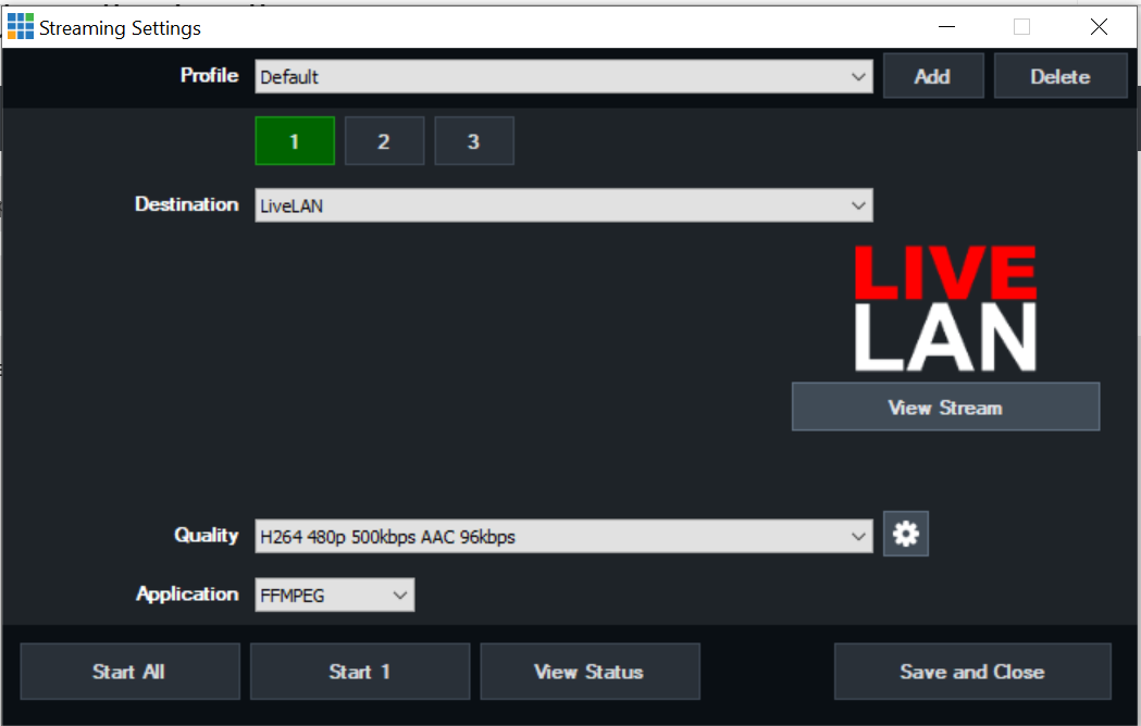

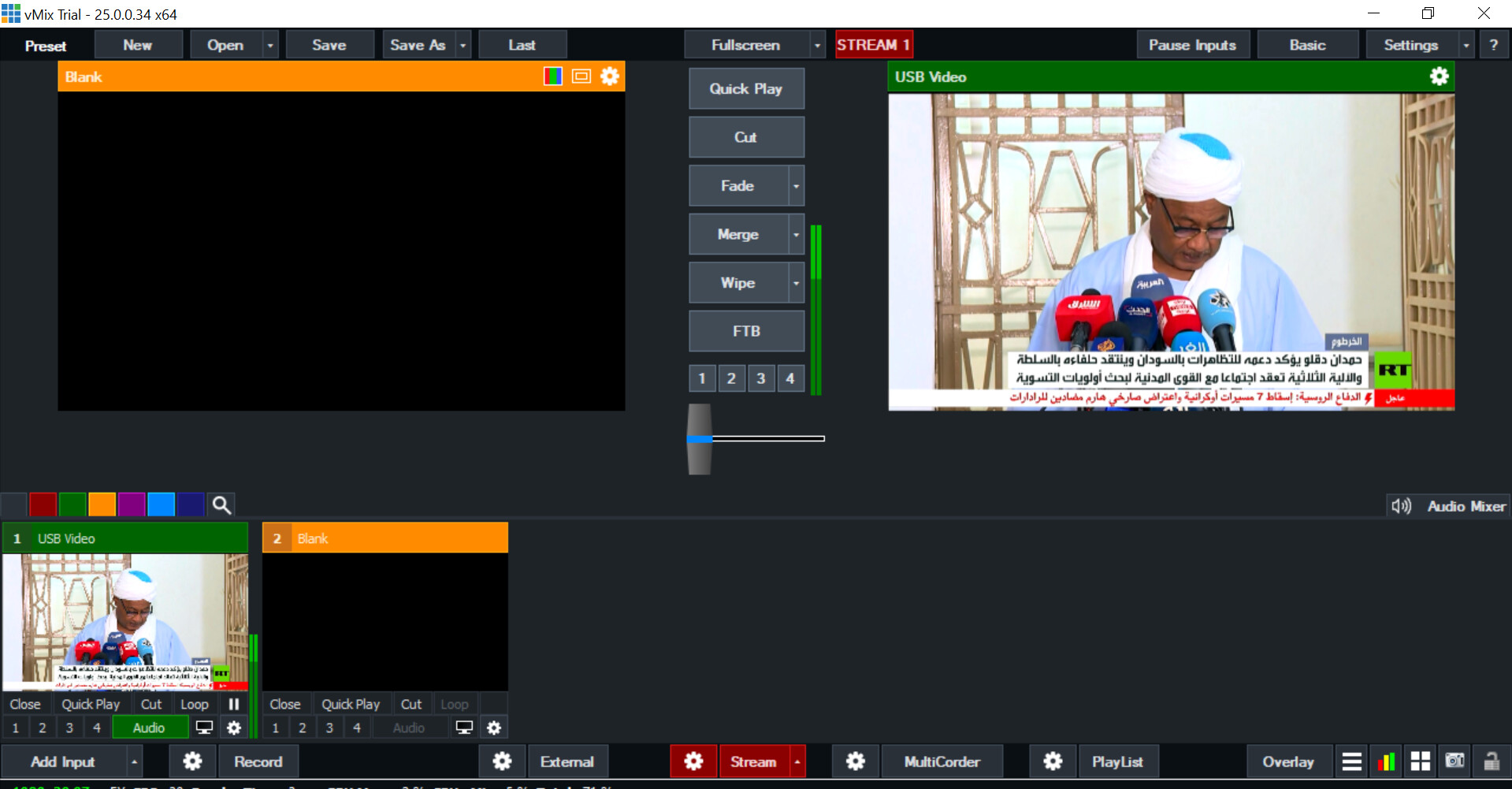

I did as shown in the snapshot of IP-Firewall also I attached all snapshots on how I did the streaming which was tested successfully between two laptops in small lan network

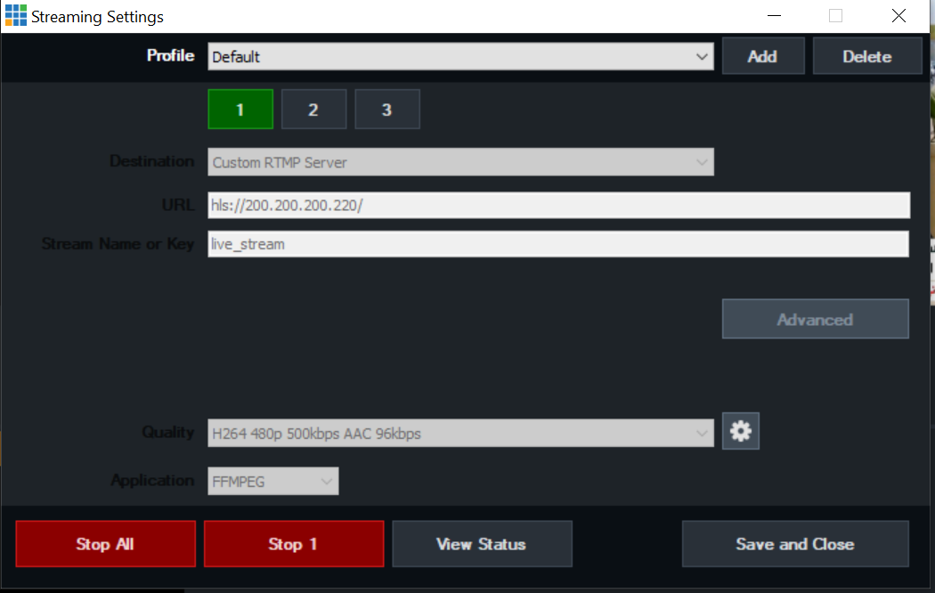

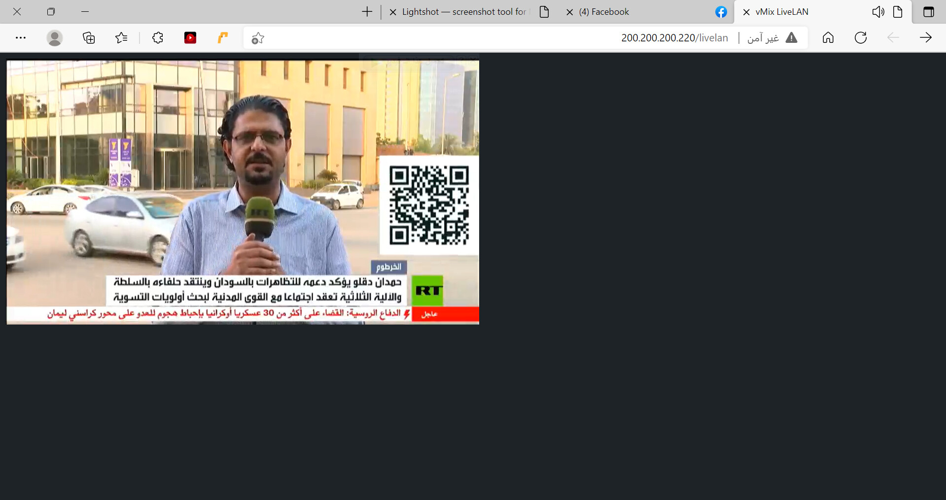

The stream works fine with the setting below:
