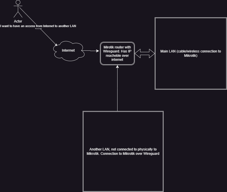

I want to RDP from WAN (internet) to my server with non-white IP
The plan is:
  • server with non-white IP make wireguard connection to Mikrotik router (which has white IP address)
  • Mikrotik setup the rule to forward traffic from WAN to wireguard peer
Draw a diagram I have no idea what the heck a white IP is for example.
I also have no clue what you are trying to accomplish speak in terms of user traffic.
User needs to access X located at Y from location Z
Not clear why RDP is needed, not clear why wireguard is needed. etc…
white ip - real (not private) IP address. A lot of IP in Ukraine is “gray” (over provider’s NAT), so not reacheble from Internet
Well, hmm okay, so you have a mobile user (actor) that needs to reach either the main lan behind the MT) or some other still poorly described LAN.
Is this LAN behind a router as well? How does it connect to the internet? Does its upstream router have wireguard.
If not how are you proposing this LAN connects to wireguard ???
Another LAN has “gray” (private) IP - behind provider’s NAT (something like 10.20.30.40)
So, the idea is to connect from this another LAN to Mikrotik router (over Wireguard or other VPN), and than on Mikrotik allow traffic redirect from “wild” Internet to PC’s in another LAN
All very doable if this grey router has wireguard capabilities which you have not made clear..
If not you should still be able to connect through the grey router from a PC on that LAN.
