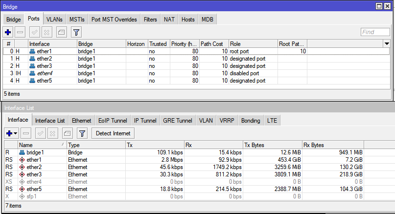

I have hex poe with pretty default configuration powering on my 3 outdoor cameras. Ether1 plugged to my network and ether 2,3 and 5 connected to cameras.
I was thinking about restricting those ports to my devices MAC only so if anyone unplugs my camera and connects other device it won’t get thru. What is the best way to achieve that? Firewall rules based on MAC?
Against stupid attackers, a bridge firewall filter linking MAC address to a port is sufficient. A clever attacker will copy the camera’s MAC address to his device, so only 802.1X is a safe method, unless the attacker can extract the password for 802.1X from the camera. The question is whether your cameras support 802.1X.
I see IEEE 802.1X enable checkbox on my hikvision cam along with some parameters like protocol, version, user, password, so I assume it is supported.
What now?
Should I find tutorial how to setup IEEE 802.1X on mikrotik yes?
Is it better to set it directly on hex poe managing only those 3 cams, or better on my central router which holds capsman as well?
