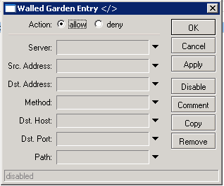

MRZ, I’ve found Google’s server IP addresses, but I’m still having trouble getting it to work. Maybe I’m messing up completely with the walled garden entries. I’ve included the blank entry here. Do you mind showing me what I need to put where and what’s not important?
Thank you in advance!

You should be able to use the domain name and the port.
/ip hotspot walled-garden
add dst-host=.gmail.com dst-port=465 action=allow
add dst-host=
.gmail.com dst-port=110 action=allow
This only works with outlook and thunderbird, not browser (port 80) email.
EDIT: My bad. The gmail.com email server requires SSL. If that is the case, I found you must enter the server IP in “/ip hotspot walled-garden ip” like this:
add dst-host=pop.gmail.com dst-address=74.125.47.109 dst-port=465 action=accept
add dst-host=smtp.gmail.com dst-address=74.125.47.109 dst-port=995 action=accept
ADD: This comes from my experience with Apache and SSL websites. The only data available on a SSL packet is the ip address and the port. The header, which contains the url, is encrypted. No such thing as Virtual SSL hosting (last time I checked).
