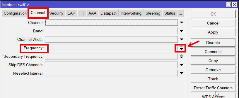

When you are in the settings for that 5GHz radio, go to tab channel and set frequency manually to the desired value.

Wifi settings, Channel tab
There you can find the field to set frequency.
But … if you say in the FIELD channel it says unkown, you have another problem.

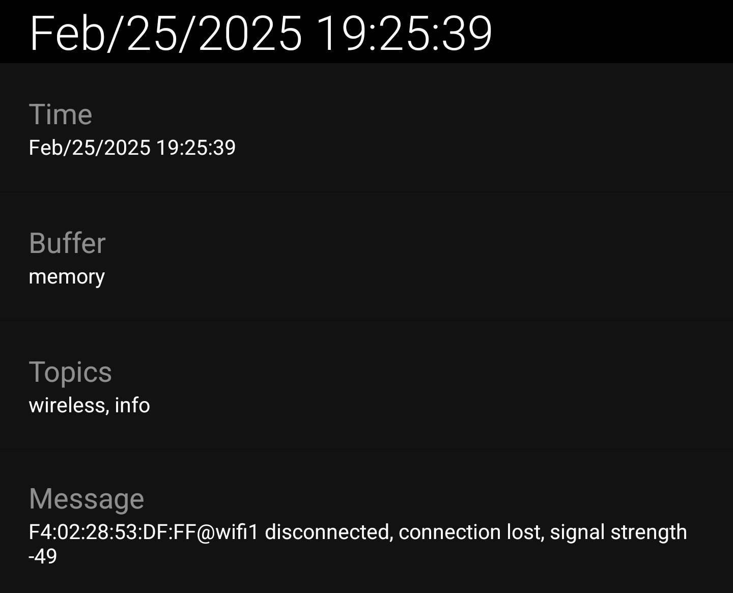

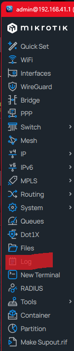

On the logs, might giving me a hand on where they are? I spent the last 6 hours in that interface and haven’t yet found where logs might be… Haven’t even bothered fixing all the LAN dynamic IPs yet since I can’t get the basic wifi working :slight_smile:
Does this help? Seems a bit short, but all I could see under logs on a connection attempt I just did.
