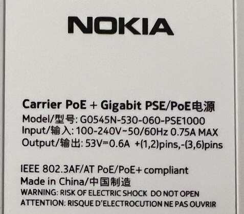

I cannot find any detail on the Nokia, the original power supply is marked as using 1,2,3,6 for power, if the thingie is actually 802.3af/at compliant it should power just fine with power on 5,6,7,8 (which most Mikrotik PoE out enabled switches will probably use) but you never know. BTW, the original power supply is 53V 0.6A so a little more than 30W and that is exactly the "soft-spot" where most Mikrotik devices are limited in current.

I tried to find something about Nokia PoE injectors but found nothing... Datasheet only provides compatible injectors...
I mean, it's possible they are doing some proprietary sh*t with poe. I can't find if they are using standard PoE.

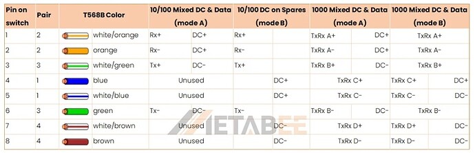

Well, it is marked as such on the power supply, but we all know how the standards are "interpreted" by this (or that) manufacturer in such a way that sometimes they become non-standard.
So, in mode A pins 1,2,3 and 6 are used for PoE.
In theory PoE capable device should be able to accept both standards but I think that safer option would be some kind of converter.
