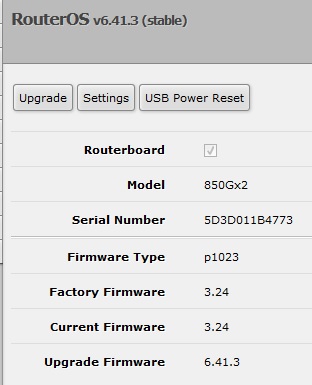

No, I haven’t updated the firmware, but I was wondering about that myself. I’ve never seen anything relevant in the updates to my 850Gx2 so never bothered. Interestingly, the router tells me that the ‘upgrade firmware’ is 6.41.3 - that’s the RouterOS version… something’s got mixed up there I think.

This is what the ‘system/routerboard’ page on webfig shows:
Yes, that’s expected. The firmware version now matches the ROS version. That change was in 6.41 iirc.
Sent from my Pixel XL using Tapatalk
Thats a good change imho
