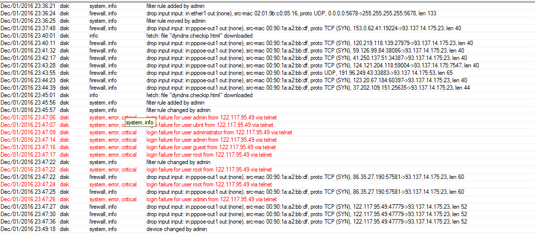

Lately i am having very strange logs in my router, also immediatelly when i enable port 23 in firewall, somebody tries to acces my router with wrong user name and password, seems like brute force, so i have to keep port 23 disabled.
This logs continue to happen, i tried refreshing my public ip addres (my dsl gives me a new public ip each time i recconect with pppoe), but as soon as i get the new public IP, i have the same loggs again.
Also i tried to disable most of the network devices (routers cameras,smartphone, pc), and then refresh the public ip, then i tried to turn of my computer and use another pc, but each time i refreshed the public ip, the same loggs shows soon after: "Drop input: src-mac=00:90:1A:xx:xx:xx "

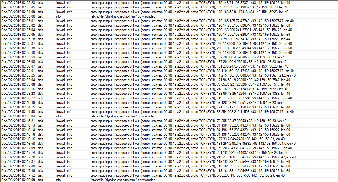

Here some example of some loggs, in the 2nd screenshot i enabled port 23 just for 30 seconds, and this was enough for the attacker to start the brute force(so i quickly disabled this port again)…?

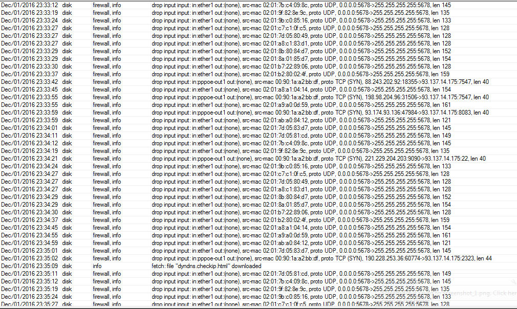

From your logs it looks like you are using DynDNS, this is probably why changing public IP doesn’t help.
UDP traffic to/from 5678 is used by MT discovery protocol: http://forum.mikrotik.com/t/port-5678-udp/17211/1
maybe this “udp 5678” log might not be harmful, but the src mac addres on him “02:01:xx:xx:xx:xx” is not from a MT device.
Still i am more concerned about the " proto TCP (SYN) log" from “00:90:1a:xx:xx:xx”,
also when I change my public ip, this logg immediately repeats, before my dyndns rule was even able to update my new ip to dyndns server.
This is the Mirai botnet, nothing to worry about. It is brute forcing telnet on the entire IPv4 internet.
why does the telnet port is open on WAN. You might need only winbox/ssh port opened from WAN, maybe some VPN server ports, but all other - drop it.

Yes, it is normal. I have around 2000 telnet connection tries every day. Nothing to worry about as far as you are dropping them. I will also recommend to disable telnet connections to the router at IP->Services->Telnet as you don´t need it at all.
Also, it is much much better to log the rule instead of disabling it just to see if there is someone trying to log in.
