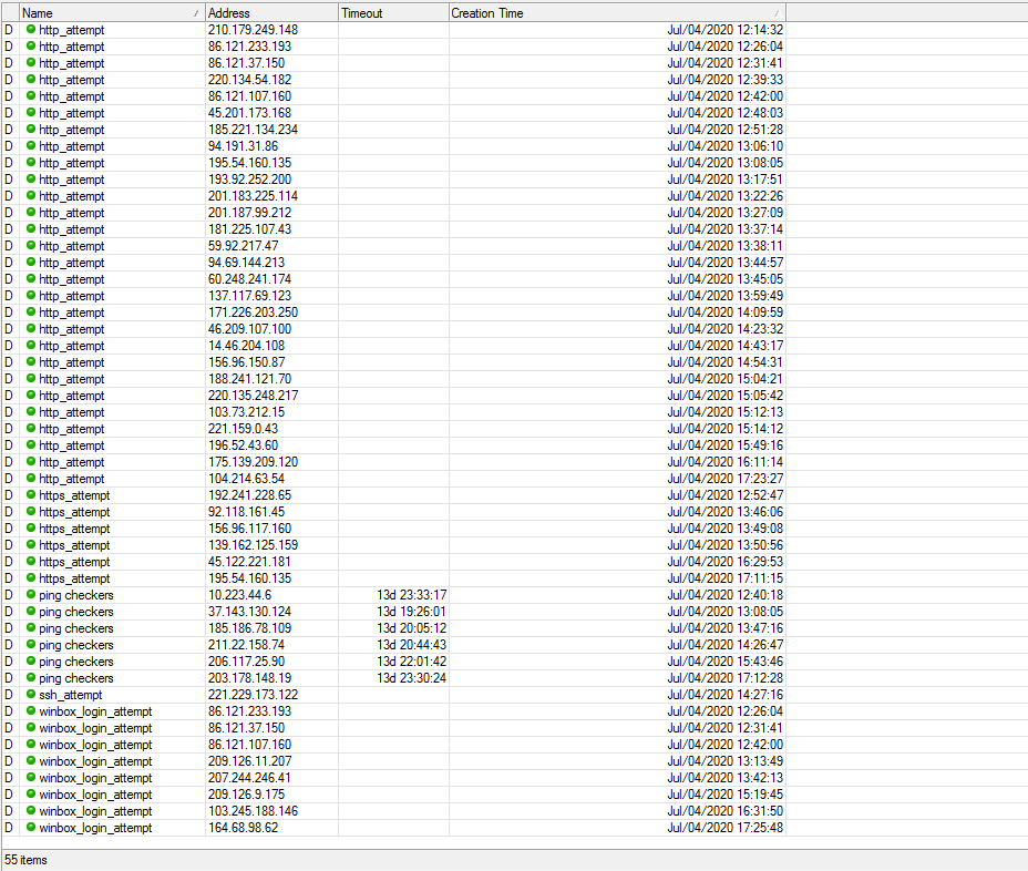

Before restarting the router, I had around 6000 login attempts(winbox/ssh/http/etc ports) in just 2 weeks of uptime:

5.5 hours later. 55 attempts to check/try to do something:
Congratulations, you have no firewall :slight_smile:

My advice was to reset to defaults and start from there.
Dare I repeat myself. :slight_smile:
I will go further, as was pointed out you have very little protection on your router.
Therefore I would go on the premise that its been compromised.
In fact you should pull the plug on the router ASAP but first.
What you need to do is download NETINSTALL and choose 6.45.9 as its a decent stable recent version
ALso download the corresponding version of 6.45.9 (the one for your router type ARM, tile MIPSBE etc..)
Then follow the instructions here… (copy a version to your desktop)
https://help.mikrotik.com/docs/display/ROS/Netinstall
Then you will have a clean router with default firewall rules.
Then you can change the user from admin, strong password, change winbox port etc…
I want to add the rules without resetting it. Where can I find the rules?
How can I check if it was ever compromised? Is Mikrotik that lousy? The password is like 20-30 characters long.
How can you bet on it being compromised if you don’t see anything suspicious in the config? There are no suspicious files stored on it, either.
Now I’m scared. It has been running for 10 years on this configuration.
I want to understand how did my config made my router vulnerable. Can you give an example?
Instead of panicking just follow the plain advice to ensure your router is setup properly with a clean config.
To get the default rules simply reset the router to defaults and they will magically appear.
Then add in your old config bits for setup but not touching the firewall rules.
However since it appears you have no input rules to protect the router itself, it is advisable to ‘swipe’ the router to a clean state,
hence the recommendation for netinstall.
Take the advice or leave it, peace out.
Can you give some examples for input rules that protect the router itself?
I just want to understand the situation.
Take a look factory default configuration
/system default-configuration print
can you explain me with an example, how I destroyed my security with my configuration?
Certain RouterOS versions had really some flaws in them in the sense that IF you ever exposed the mangement interfaces externally (eg. http/https) your device could be hacked! No login needed :wink:
I was under the impression that you had a “default” config (with enabled/active firewall rules rules) hence my remark that what you did extra was pretty OK.
anav, you scared me so much that i’ve just reset the router, reinstalled routeros 6.45 using netinstall and I’ve connected to it’s default ip/credentials.
I went straight to the Firewall window in Winbox, and I find it empty.
Why?
jvanhambelgium, they are talking about some default configuration for the firewall rules that I was somehow missing and that could have had some bad consequences. So I reset and reinstalled RouterOS, and I see no default firewall config to exist.
Where is the mistake?
