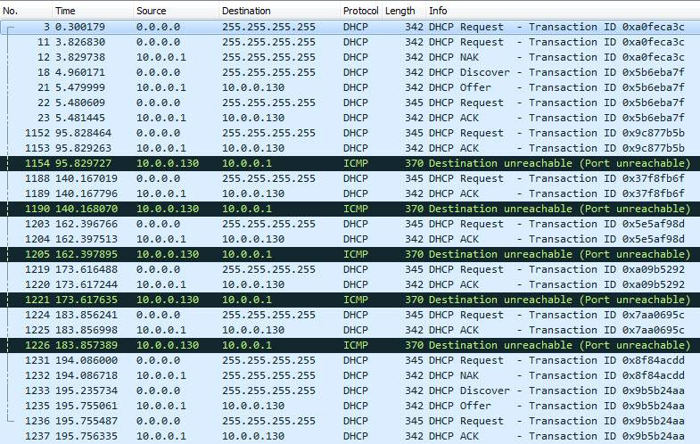

I also have a FireTV 4k and I investigated the problem in more detail. I used Wireshark to capture the DHCP renew communication between the router and the FireTV and came across a strange behavior. I set the lease-time to 3m so the renew occurs more frequently and is easier to capture.
The capture contains the initial assignment (cable was plugged in) and one renew process.
FireTV capture:
The FireTV sends a Broadcast DHCP-Request approximately 90 seconds before the lease is going to time out. The Mikrotik router responds with an DHCP-ACK containing only the remaining (short) lease-time. This procedure is repeated several times until the lease finally times out.
Then the FireTV drops its address and sends a new DHCP-discover. It gets assigned the same address with 3m lease-time. During that process the FireTV looses the network connection for approximately 20s.
There are also some strange ICMP packets that seem to have a problem. The router has no firewall configured and I can ping it from a laptop without problems. So I am not sure what’s the deal with them and if they are related to the problem.

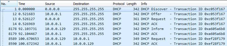

Windows 10 capture:
In contrast a Windows 10 laptop sends a Broadcast DHCP-Inform 90 seconds before its lease would expire; gets an DHCP-ACK from the router and then sends a Unicast DHCP-Request directly to the Mikrotik. The router responds with a DHCP-ACK and new lease-time of 3 minutes.

Those ICMP packets don’t have a problem, they indicate a problem.
The router sends back a DHCP ACK and the device says that the port this reply is sent to is unreachable.
You need to re-do the trace and expand it to full detail for one of those DHCP request/DHCP ack/ICMP exchanges,
and maybe also for the correct one. Then look into the several option bits and fields and see what is different.
It may be something simple like a “broadcast” flag with incorrect value, or the device may want to receive the
reply as a broadcast instead of a directed reply.

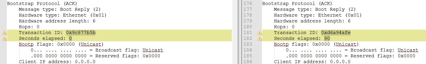

Thank you pe1chl for your response. I tried what you suggested and captured the renewal process when the FireTV is connected to a different router. I used a ZyWall USG 100 (works fine with the FireTV).
The DHCPREQUEST sent from the FireTV is identical (apart from checksums and IP addresses).
The DHCPACK responded from the routers is however different in some parts.
The setup with MikroTik is shown left; the setup with the ZyWall is shown on the right:
First difference is that the “seconds elapsed” (secs) field in the dhcp packet is set to 0 by MikroTik (in contrast the ZyWall set it to 90).
In the RFC2131 on page 9 it is stated that this field is “Filled in by client, seconds elapsed since client began address acquisition or renewal process.”. This defines the field in the DHCPREQUEST. On page 27 there is a explanation that the secs field can be 0 in the DHCPACK packet; but this is referring to the initial DHCPDISCOVER message.
So I think this difference doesn’t matter regarding our problem.

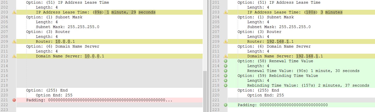

The second difference is that the “IP Address Lease Time” (option 51) is responded with the short remaining lease time by the MikroTik. The Zywall reset this value to the initial 3 minutes.
The third difference is that the “Renewal Time Value” (option 58) and the “Rebinding Time Value” (option 59) are not sent by the MikroTik at all. Those options where requested by the FireTV.
In the ZIP-File I attached are the Wireshark pcapng files as well as the two text-files you see in the screen shots. The text files contain the two packages that are involved in the renewal process in full detail (one DHCPREQUEST and one DHCPACK package for each setup).
Can anyone confirm that the DHCPREQUEST from the FireTV is correct?
I am wondering if the responded (short) lease time by the MikroTik is correct. Should the ACK from the MikroTik look like this?

I think it does not look that bad…
Of course the lease time from the MikroTik is very short, but I think you have set that yourself to debug it.
(i.e. you could set it higher in the DHCP server but then you have to wait longer to reproduce the same issue)
You could try adding the two options manually to the MikroTik DHCP server (a somewhat laborious task, but
it is made simpler because you have the packet from the ZyWall where you can see these options) and check
if that solves it.
When you did this test, did you still see the related ICMP message and was it present on the ZyWall as well?
Because when the router rejects the ACK that way, of course it is not going to process it, and playing with
option fields is probably not going to help.
