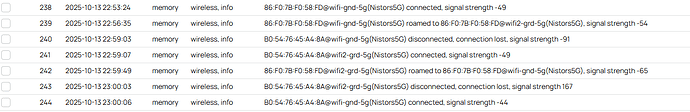

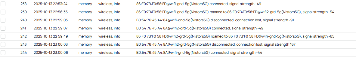

As for logs:
  • the 86:F0… MAC is Android 15 and roams through the house just fine
  • the B0:54… MAC is Android 16 and simply drops the connection when signal becomes too low

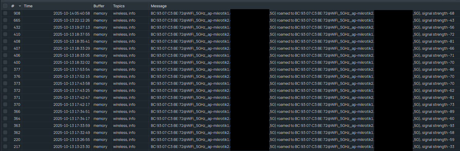

I have a Galaxy S24 Plus, recently upgraded to Android 16 and I can still see in the log that from time to time it is being roamed between my two wAP ax access points (I’m using CAPsMAN on E50UG). I’m even using WPA3. I can post my config if you want.

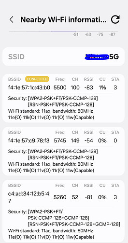

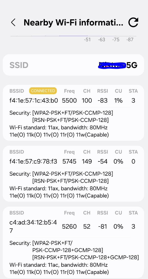

I’m still pretty sure the issue is with the phone itself. Found a hidden menu that shows this:
The phone sees all APs and still chooses to hang on to the bad signal one.
One proposed step on Samsung forums was to reset my phone but that’s a though one…
