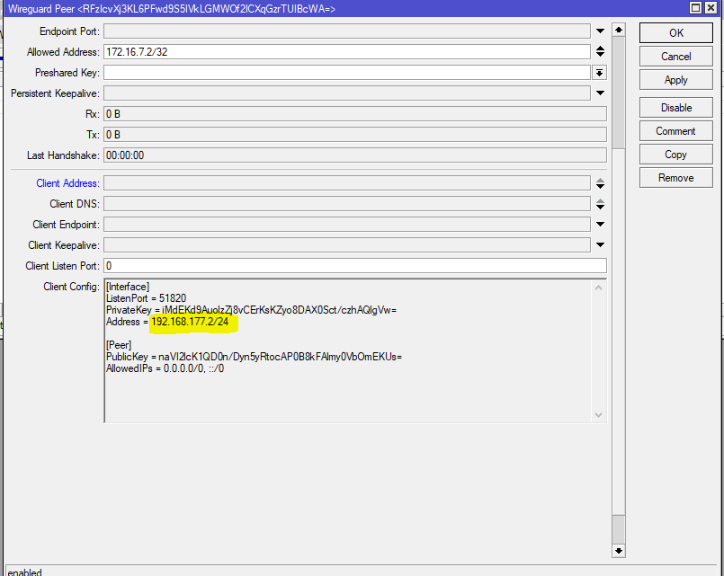

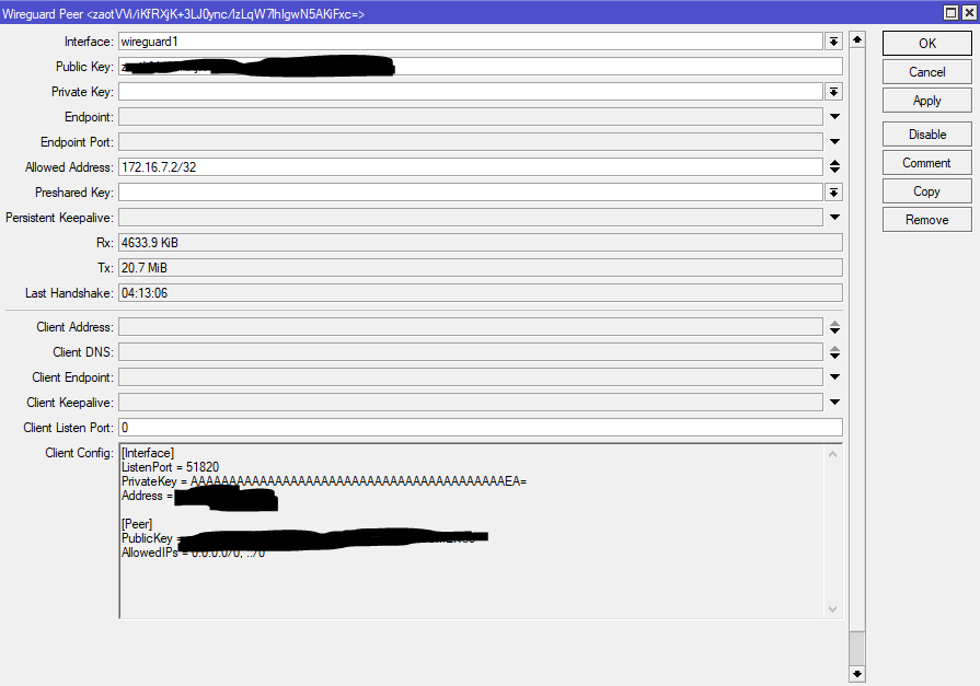

Yes, QR code is visible in Winbox/WebFig in WG peer configuration

I have not found it yet in the peer configuration.
can you please post a screenshot of QR in peer configuration?
I think this is related to ROS version, not sure on which is introduced, I have latest 7.13.5
and port
Thanks for your answer
1). but here is a problem I want to use IP with my ranges and ports but it shows default IP 192.168.177.2/24: 5180.
