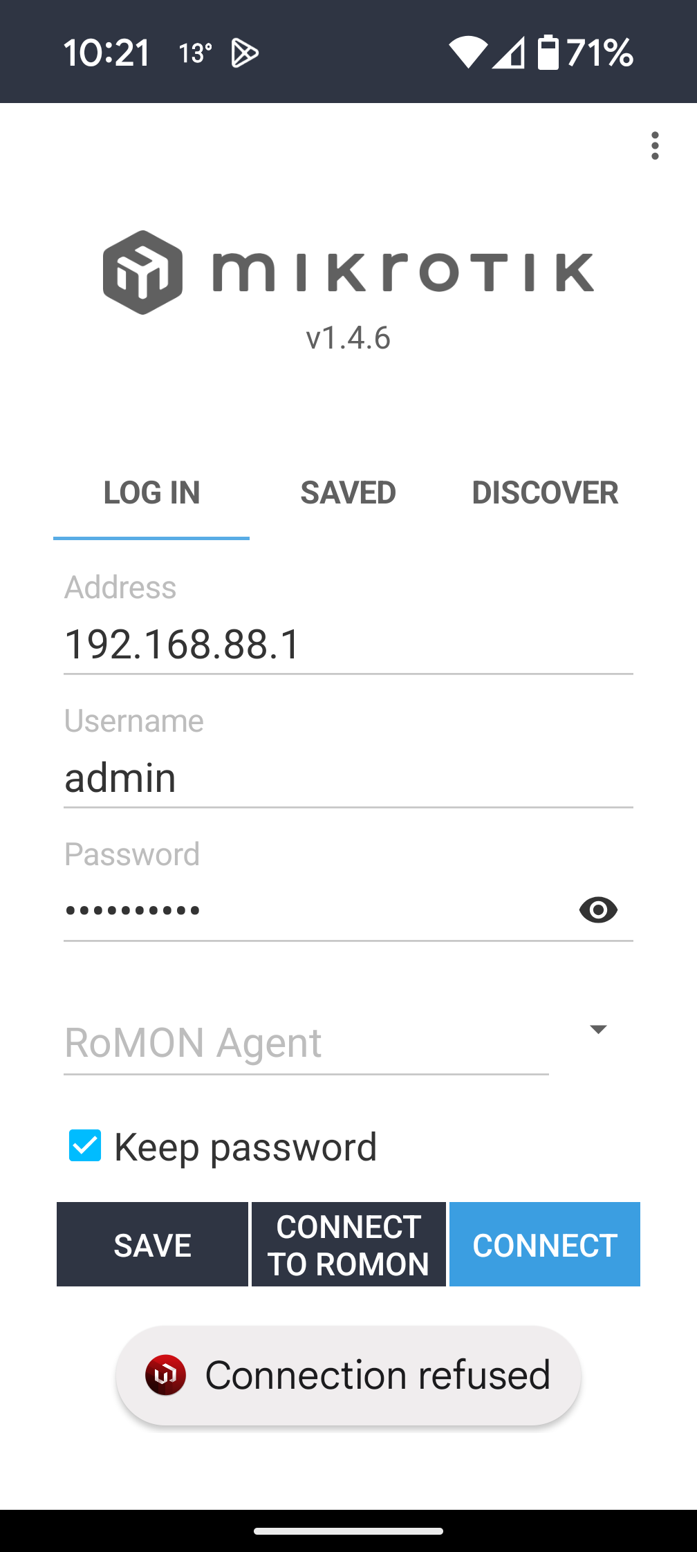

Good morning,
I just setup the router and I want to use the android app, sometimes I can log in, others not,
It’s annoying. Can anyone advice how I can resolve this?

I use the lan port for starlink. I gets slow speeds and time outs. I just did the quick setup on the app. Once created, then the lost connections appear and the speed test are low. When a use a GLiNet router, no issues at all and fast speed tests. So my setup on the Mikrotik router is not right. The clock is out of sync - but thats an easy fix with ntp server.
