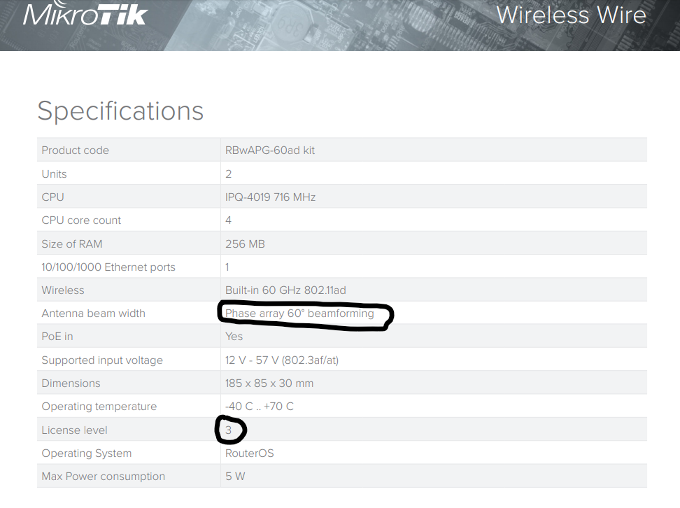

I purchased a wireless wire and noticed that both units are WAP-60g AP units.
Are they the same hardware for ap and station.
How many degrees does the WAP-60g AP serve? 60? 90? 120?

Phase array 60 degree beamforming
Yes, but is that the width of the beam? What the total area covered by the radio? One would think that is some multiple of 60.
Duh. 60 Degrees is the angle and if you look at hardware section you see also a X3 (new) version that has an angle of 180 degrees. The width is limited by the distance. I won’t reach the planet Mars despite it could be well in the 60 degrees angle.
From the Mikrotik wiki and if you look at the LHG version with a 3 degree beam you will understand the 60 degree beam.
Physical Properties
Atmospheric attenuation for the wireless frequencies used in 802.11ad standard is very high, this should be taken in account before deploying links.
The Wireless Wire kit have been tested in distances up to 200 meters.
Wireless Wire dish kit is tested at distances up to 2500 meters For stability and full speed availability this kit is recommended for distances up to 1500 meters.
wAP60G devices are equipped with phase array 60° beamforming antennas, that can help signal find the way around objects in short distances but it’s still vital to keep the line of sight clear on higher distances.
LHG60G device single radiation pattern is less than 1 degree (both Horizontal and Vertical), All patterns combined provide close to 3 degree coverage in both Horizontal and Vertical planes, best one for each situation is calculated by using beamforming algorithm. Beam width and direction depends on used predefined calibrated sector.
https://wiki.mikrotik.com/wiki/Manual:Interface/W60G
“60 degree” means that generally antenna is capable of transmitting/receiving in direction which is ±30 degree from direction where antenna is pointed.
“beam forming” means that antenna actively forms a narrower beam in some particular direction within the general angle range. Theoretically it’s not necessary to fine tune antenna azimuth and tilt, the beam forming algorithm should take care about that.
Beam width of such formed beam is quite narrow, as @msatter wrote it’s 1 degree.
Altogether: it means that the other end of the PtP link should be in general direction of antenna (± 30 degrees) and that upon link establishment, antenna will form a narrow beam hugely increasing link quality - difference between 60° beam and 1° beam is around 35 dB which is effectively difference in antenna gain. One has to take care about EIRP on Tx side, but on Rx side, these 35dB are net gain (largely increasing SINR).
