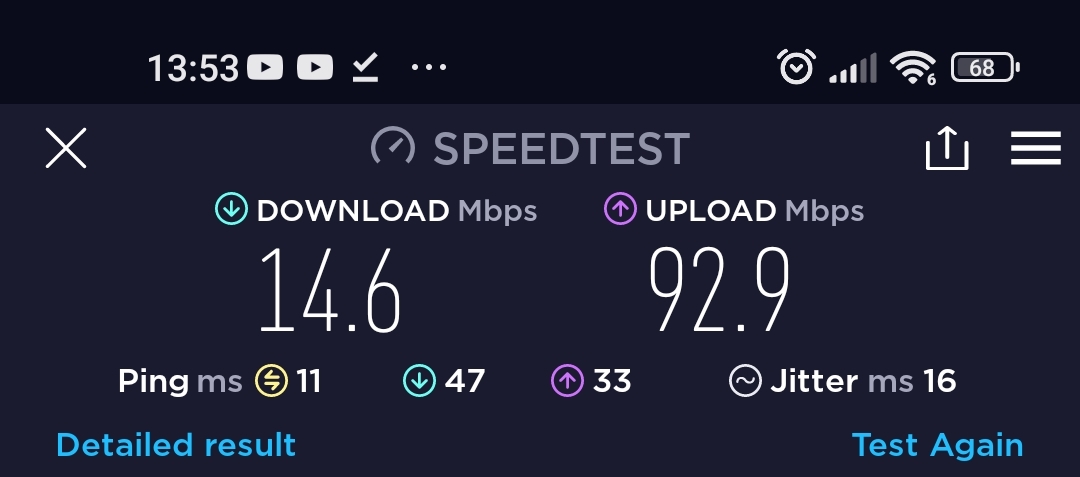

So, today new issue… WiFi link speed 1200 Mbps, Speedtest 14 Mbps down, 91 Mbps up (limited by superfast 100Mbps link speed) wifi is crapping out all the time… All devices wants to connect to ax3 which is working for now.

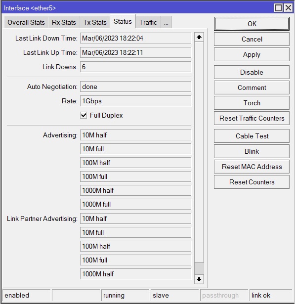

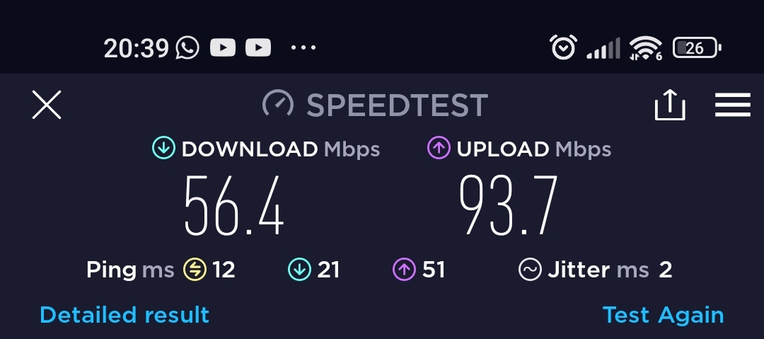

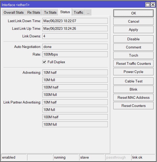

Little update:
Today I tried to do simple test, ether5 on my ax2 was free so I make it trunk port instead of ether1 where I was only able to get 100Mbps and you can see results in pictures:
Original trunk on ether1:
New trunk on ether5:
VLAN config is the same for ether1 and 5, there is something wrong with ether1 on ax2, both of my ax2 have same problem…
