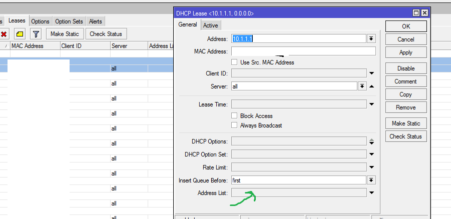

another bug in routeros
v 6.19 CCR1016
does not show address-list values in dhcp-server lease tab,
it does not show address-list parameter in CLI too
if I add it in winbox it appears in winbox only (not in cli) and after restarting winbox it disappears.
somehow it adds them to address-list in firewall when lease is bounded
everything works fine in 6.11

I can confirm this on a CCR-1009-8G-1S-1S+ running 6.19.
Nothing new. You should search forum first. http://forum.mikrotik.com/t/new-problems-appears-6-19-kernel-failures/80516/1

Your topic name is also telling nothing about the content. So that is how it is mostly. The problem with address list is described in details together with workaround. You just opened a thread with the same so I pointed you to original topic where the problem was discussed first. What’s wrong with it? You cannot say you discovered something when it was already described before and support ticket exists for this.
