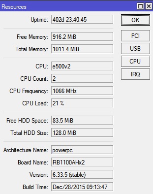

We have 1100AHx2 running forever in bad conditions. Seems CCR is not as robust?

just for fun :smiley:
There are some boards which live forever. E.g 1xx or 512.
