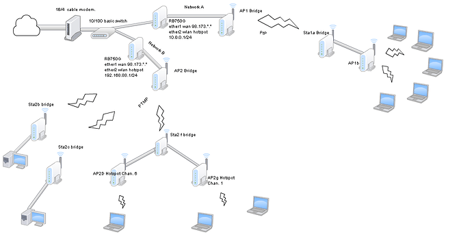

Another how to create a VLAN?
Based on the attached Diagram.
If I want to add 2-3 vlan's to the hotspot on Network B so that Wireless customers (laptops) see 3 -4 SSID's with different subnets behind either one of the Wireless AP's?
1, Do I need to add a vlan capable switch behind the RB750G? ? Or is the hardware shown in diagram sufficient?
2.What is basic configuration, i.e., where to add bridge? which interface to use? how to add new subnet to vlan?
I've got the standard out of the box Hotspot installed.
  1. Does anyone have any examples with similar configuration, that would show me how to create vlan's.
    Thanks in advance!

Without knowing more about your hardware it’s hard to say what you will or won’t need, though I can tell you in general a good managed switch is not a bad idea to get. They can make your life much easier and give you several options that you wouldn’t otherwise have. At some point however you will need VLAN aware devices so the traffic can get where you want it to go.
The first thing you need to understand about VLANs in MikroTik is that they are handled in the same way that Linux handles VLANs, each VLAN is an interface unto itself. It is not like a switch where you can assign VLANs to an interface to have the port listen to it. This means each VLAN is independent of each other like each Ethernet interface is independent of each other. You can either run a separate Hotspot and subnet on each VLAN, or you can tie them all together with a bridge and run a single hotspot and subnet on the bridge interface itself.
If you want all of your VLANs to share the same hotspot, here are the steps that you follow:
1.) Create all of your VLANs.
2.) Make a Bridge for all of your VLANs to be a part of.
3.) Assign all of your VLANs to that bridge, and VERY important, assign them a horizon number. This number should be the same for all interfaces.
http://wiki.mikrotik.com/wiki/Manual:MPLSVPLS#Split_horizon_bridging
Without this settings, the setup can break down very very quickly.
Also as a note, you cannot have the physical interface that holds the VLANs as part of the same bridge. This will break the setup. What this means to you is that if you want to use this setup everything leaving the MikroTik needs to be tagged and everything coming into the MikroTik needs to be tagged.
If you want to run separate hotspots and subnets for each VLAN, then make the VLANs and assign different subnets and make a different hotspot instance for each.
Thanks,
Yeah, I want to run separate hotspots.
To start, So, I do not need a VLAN switch down stream?
The Radio hardware is all VLAN capable.
I’ll give it a go tonight, with what you suggested.
If your current hardware is VLAN aware, then you should be fine. As a general rule an un-managed switch or bridge should just pass on the VLANs without modifying them.
The important thing is not to pass VLANs to the clients provided it’s not a CPE that is VLAN aware. Most operating systems do not recognize VLANs by default and passing them VLAN traffic will cause it to just drop the packets as it doesn’t know how to read them. This means you need to strip off the VLAN tag in the hardware right before it reaches the client. This is done with a MikroTik by making a bridge and assigning it one physical interface that the client connects to and a VLAN that is not assigned to the physical interface on the bridge. This way any traffic coming in on that VLAN interface will have it’s tagged striped when it leaves the physical interface, and any traffic coming in on the physical interface will have a tag added when it leaves the VLAN interface.
VLANs are great for creating different logical networks using the same hardware, but if this is your first time using them I would recommend setting this up in a lab environment, or at lease somewhere where you have quick access to all hardware. If you do it wrong it can be very easy to lock yourself out of stuff. Just remember to think of each VLAN in MikroTik as it’s own physical interface and it should get you going down the right path.
Thanks,
So the wireless AP serving clients is the Unifi device by UBNT, I still haven’t quite fiigured out whether or not they’re actually VLAN functional. They do have the option in the software config, but whether or not they actually work, I’m not sure. Haven’t read anybody actually making them work yet.
Regardless. The new firmware on the UBNT radios are able to pass vlan traffic, from what I understand.
But back to the MT router where everything starts.
I’m going to follow your suggestions with configs on the MT device and set the network up as though the WAP will work.
It’s definitely not a production environ, yet… So, back to the drawing boards.
