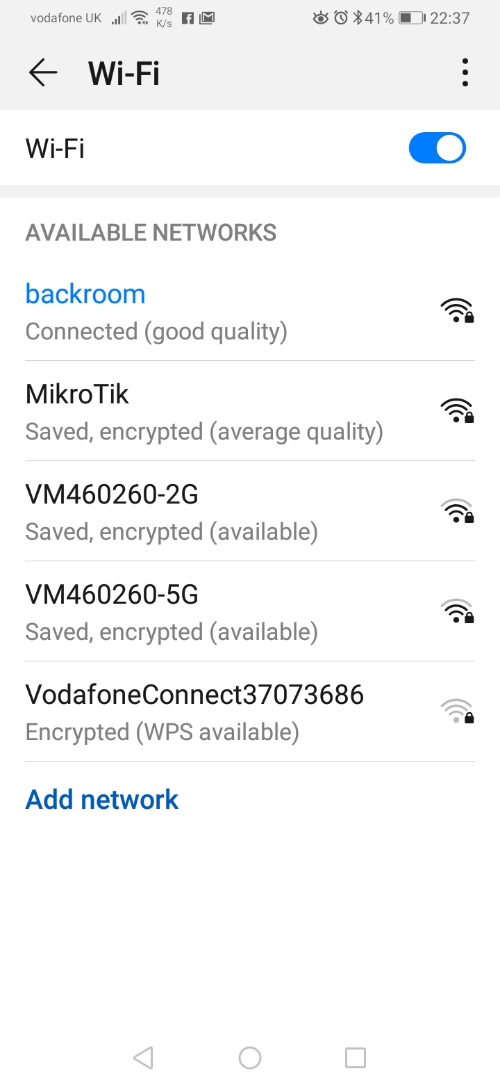

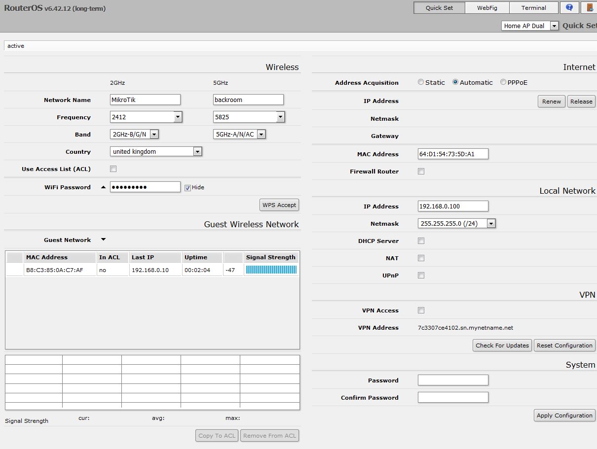

Essentially I am after advice to see what my best route is. My wifi is from a Virgin media Super Hub hard wired to the Mikrotik box that is in the back room near the garage..I would like wifi in the backroom and garages to run my chromecasts that are on all TV’s
I have screen shot the setup as I have very little clue what I am doing other than it works but the chrome casts are stuttering and soon drop signal all together.
They all work fine when in the same room as my Virgin box.

What I am needing to do is reset my hap ac Lite so I can take a lead from the switch in my back room and use the hap ac lite as a wireless access point I think its termed so I can walk between room and my wifi does not need altering on my phone.

Not clear from your posting where your WiFi is coming from now. The assumption is your “new router.” Is it a MikroTik router or what?
Also assuming that you are asking how to turn your hAP ac lite into a simple wireless access point with no other functionality.
In brief, put all the interfaces into a simple bridge, then set up the desired wireless interface parameters (ap-bridge, SSID, security key, frequency). You may want to set up a DHCP client on the bridge interface, so the hAP pulls an IP address of its own for debugging purposes. Everything else pretty much falls out.
