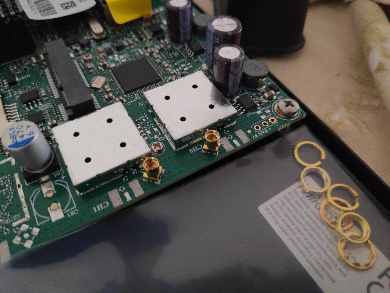

I’ve recently bought a RouterBOARD RB922UAGS-5HPACD. Unfortunately, I could not find the type of the antenna connectors on the board. The only specification I found said MMCX, but MMCX connectors are smaller and don’t fit (I think the MMCX connectors would have been on the case) and I couldn’t find it in the data sheet, either. I’ve tried a CRC9 adapter, but it seemed to be a bit too large. Since it came with a sticker warning about turning on the board without antennas connected, I don’t think they’re integrated either.
Can anyone help me find the name of these, so that I can get a fitting antenna? I’ve attached an Image.
Thank you!
There are MMCX and MMCX RP connectors, you must be using the other type. MikroTik has the right ones for sale:
https://mikrotik.com/product/ACMMCXRPSMA#fndtn-gallery
I had these small, flat ones - I will go with the Mikrotik adapter.
Thank you so much! :slight_smile:
Maybe you mean uFL (small flat ones).
