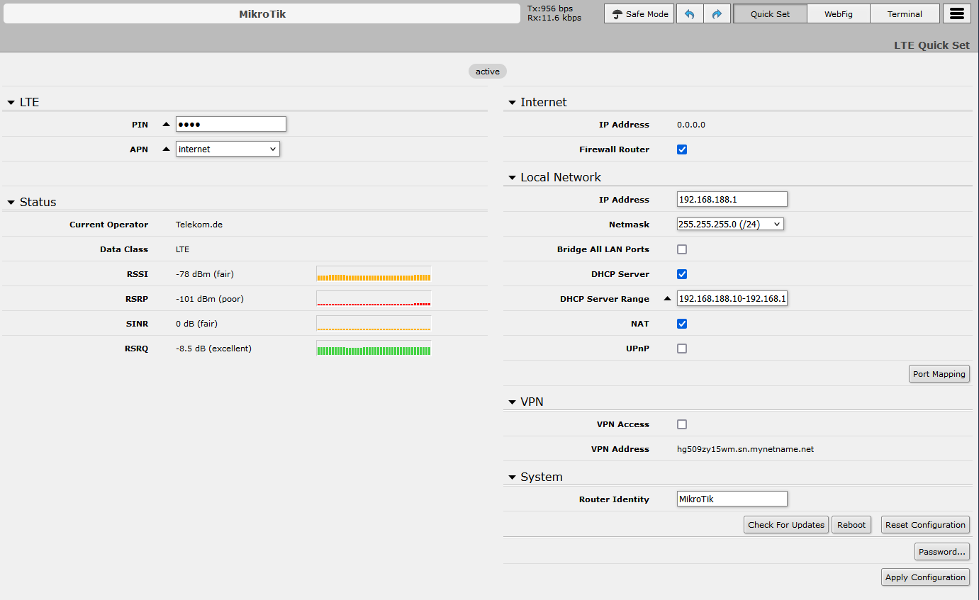

My status now is:
  • updated locally to 7.16. from 7.12.2
  • updated locally to firmware 16121.1034.00.01.01.04 from 16121.1034.00.01.01.03
  • SIM is connected to Telekom with fair to good signals but unfortunately still no internet access. Internet IP is set to 0.0.0.0
    See also screenshot
I have not changed any parameters lik APN settings o.e.
As with my first start of the device with 7.12.2 and 16121.1034.00.01.01.03 everything worked fine “automaticly”, my question now is what could have changed with the update of the router-os ?
Did you try to input APN from your ISP or did you set “Use network APN” ?
Did you try your sim card in another device ?
The SIM-Card works fine and “automaticly” in my tablet
Yes, I tried both ways of APN
Only thing that i can think of is to netinstall the antenna and see if problem is still here.
Thanks again for the ideas.
Now, after configuration reset again and several versions of the ISP APN’s I got it running.
Still strange that with the 7.12. it had started without any problems …
So it was APN problem then ? I always ask operator what APN is and I write it down on the SIM card package just in case.
