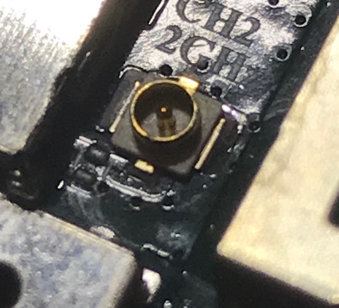

Those are SWD coaxial switch connectors. You can plug into it using something like this: http://www.woken.com.tw/product_00100A1H4W395R_spec.html
Different manufacturers call this connector differently.
It works like a switch - if you plug into it, a path to the antenna will break and signal will go only to the connector.
With this connector usually, there is no need for soldering to hijack the signal through the connector.
I would just like to add, that these are used for internal debugging, they are not meant for antennas, and you will have difficulty finding the needed adapters. But they could work as antennas.

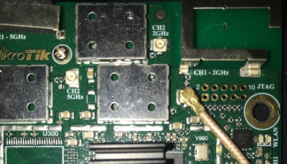

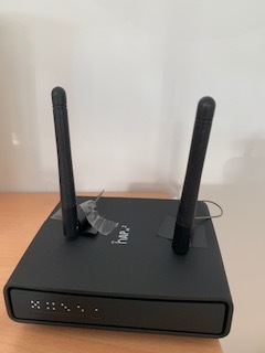

I faced same issue , installed Mikrotik HAP AC2 in room 1 , room 2 , with one wall in between and 8 m away, no signal. Opened the box , relatively easy to open, found the two antenna connections , fitted external antenna from an older router and yes ! 100 mbps at the router , thats the provider speed and 80 mbps at in another room , 8 m away.
Just that the HAP AC2 looks litte untidy. but no speed loss .

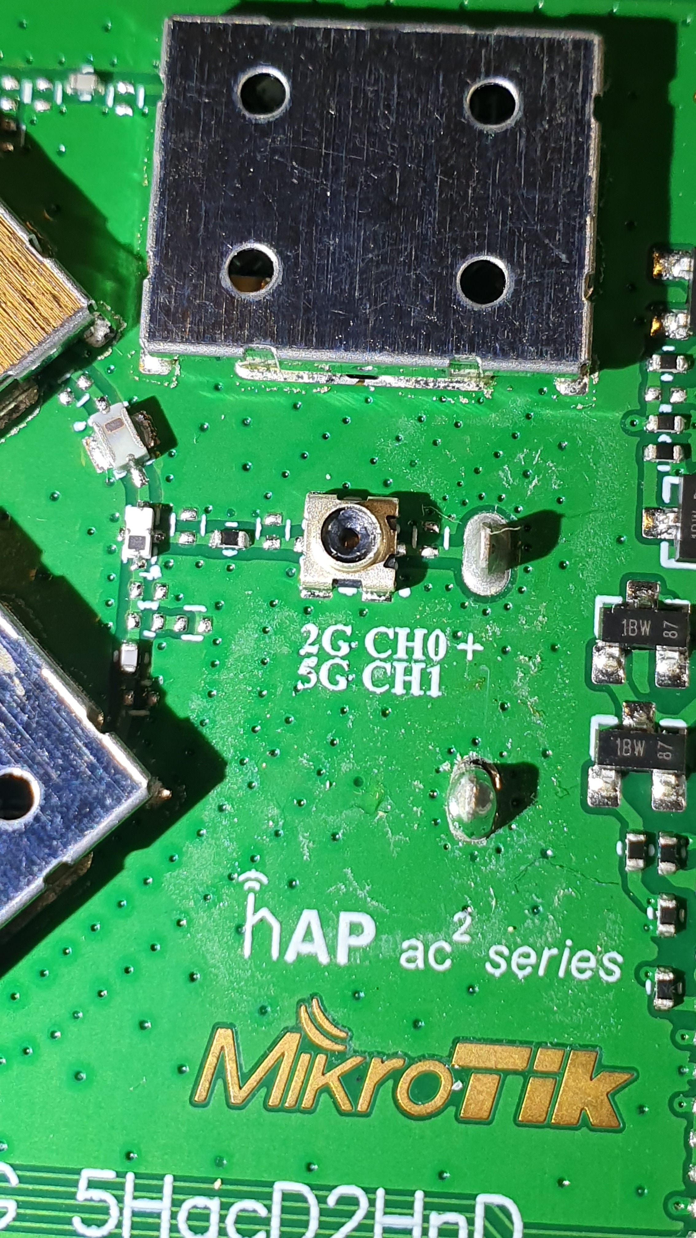

just tested the same connectors on a hAP ac with an u.FL to RPSMA pigtail, seems to fits perfectly, see attached photos.

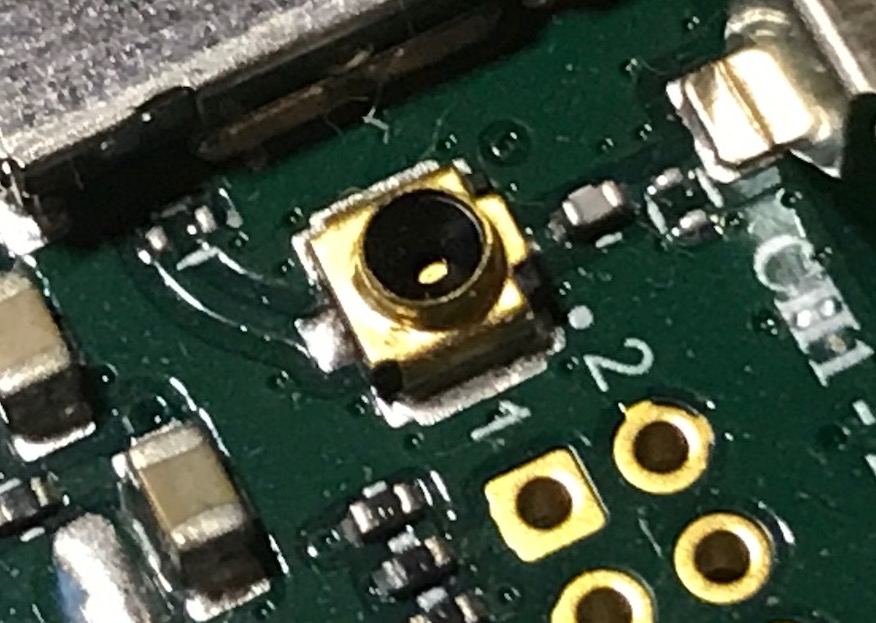

the actual connectors on the boards are pretty different though. i added two close up photos from both, and i am wondering how is that the regular uFL is making contact with the special connector without the protruding pin.
UPDATE: it’s quite possible we need a male u.FL plug on one end. and i am not sure how solid this joint would be

After not finding any suitable connector I went with the old ways, desoldring the internal antenna, attaching a rp sma cable to to the antenna connection by soldering. Now my range has tripled with a 9dbi antenna

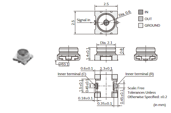

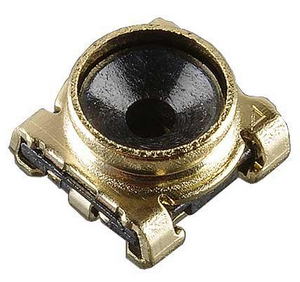

There are at least two possible options. As ArtursL and normis said these connectors are meant for debugging purpose.
I was searching for the same connector and found this. https://www.murata.com/en-eu/products/connector/switchconnector
1.MHF-SW23 made by (I-PEX) DAI-ICHI SEIKO Co., Ltd https://www.i-pex.com/product/mhf-sw23
2. MM8130-2600 made by muRata https://www.murata.com/-/media/webrenewal/support/library/catalog/products/switch/switch/o30e.ashx?la=en-gb&cvid=20210430074627000000
Option 2 is most likely the one we find in our devices.
You need something like this plug: https://www.i-pex.com/sites/default/files/downloads/pdf/CATALOG_MHF-SW23_PLUG_E.pdf

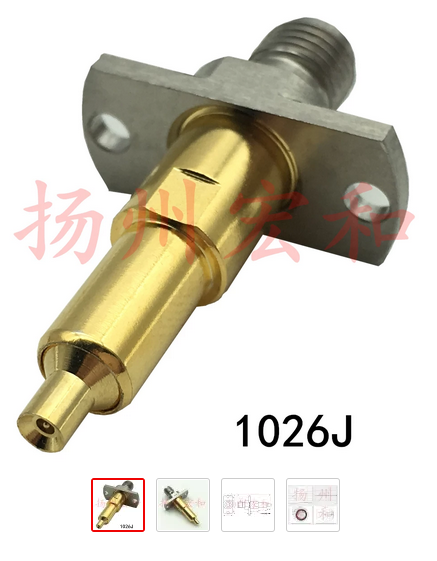

Usually, during manufacturing process are used these type of connectors : https://www.aliexpress.com/item/32959006558.html
