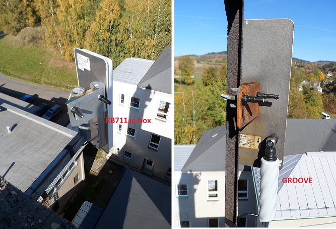

Use any sector 5Ghz antena with http://routerboard.com/RBGrooveA5Hn

Metal Groove is more powerfull but you didn’t say if you need dual chain or not. Sxt and omnitik are dual so I belive you still need dual. For that you need an ubnt 20dbi sector antenna and a RB711A 5HND. But you will not be in the budget I belive.
I read his post, but there is no wirelles device stronger then grove (metal)
If you need single chain, you can use METAL GROOVE with sector antena

If your AP is omnitik and you have used both CHAIN - it means you use two polarization (Vertikal and Horizontal)
Then you need dual chain SECTOR antena with dual chain routerboard (rb7115HnD)
If you use only one polarization then you need single chain sector antena (in my previous photo) and single chain routerboard (groove or 711)
