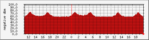

If your links were higher above sea level, say another 100m, would tide still have a large impact?
I may have only 3 clean bands but I can charge for one day of use the same as you charge for a month of use.
Have you seen the kind of prices ships pay for satellite access?
My brother works on ships. He uses a cellular data card very successfully when near the coast or on a river for Internet. You’d have to reach well beyond the range of cellular to be useful.
On my link, my end is about 100’ ASL, the other is 25’ ASL. We also see the same thing at another location where the tower is 600’ ASL.
