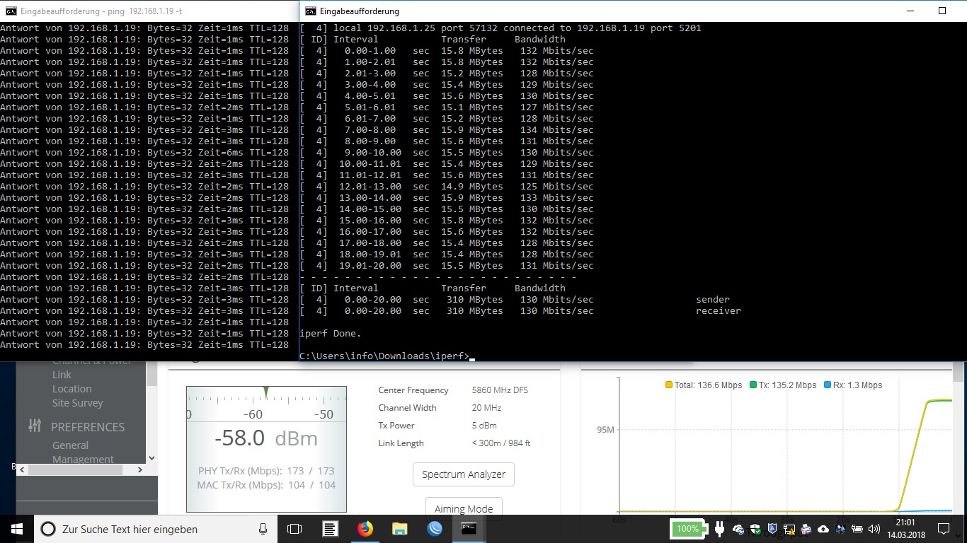

Today I did my first test with Ligowave… Performance is great, and price point to!
130MBit real TCP Troughput @20 MHz Channel
