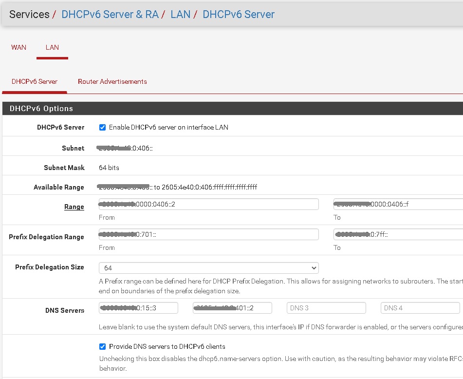

There are many easy to follow examples of PfSense IPv6 DHCP available on google and the PfSense forums.
Here is one of my PfSense IPv6 DHCP servers I use.
