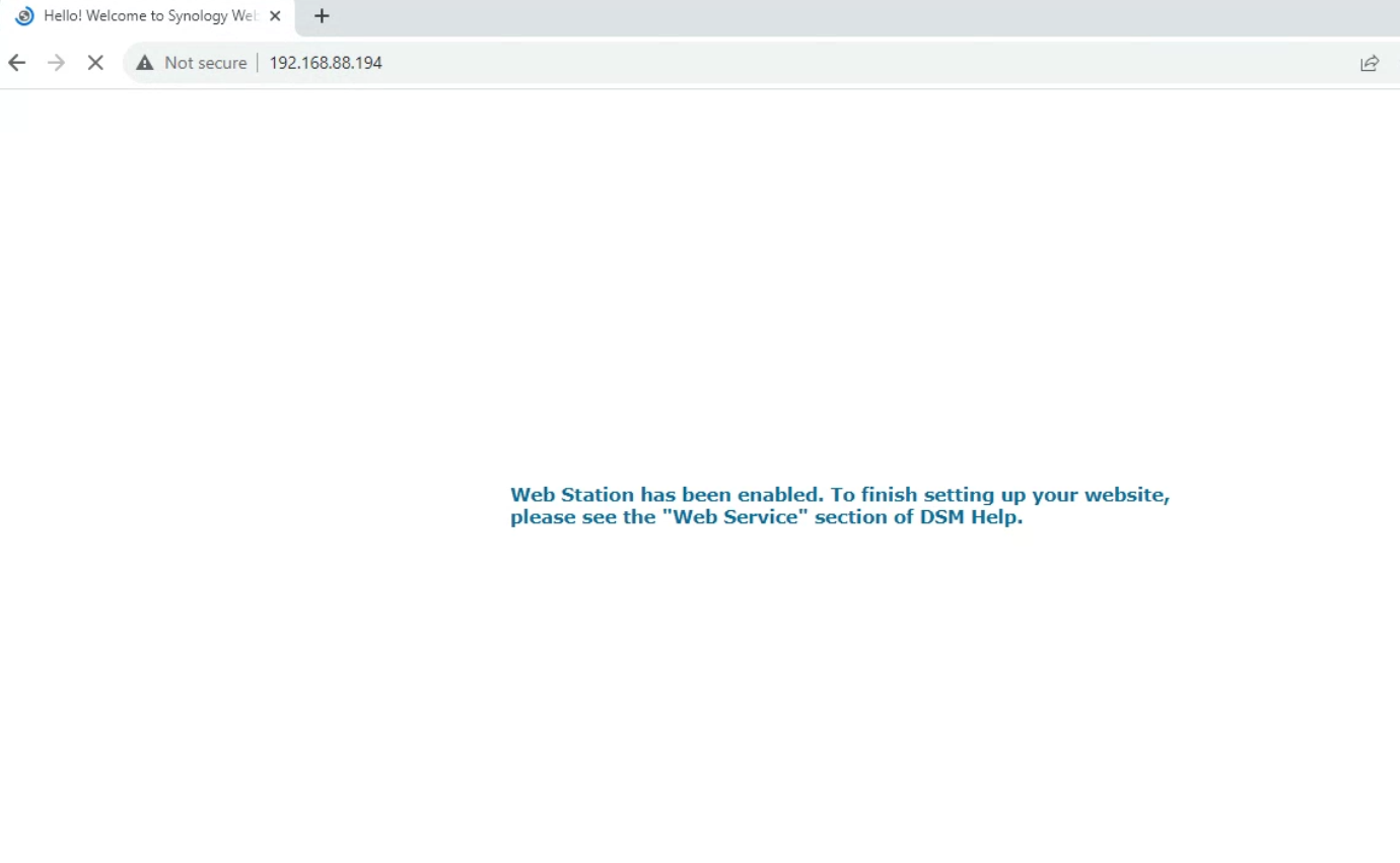

Earlier today I also couldnt connect from my own home PC, but now suddenly I am able to a few hours later. Not sure why.. here is my config anyway.
Still can’t connect on a certain remote laptop we have on a customer site. When I type the IP of the NAS into a web browser, it loads some of the text on the page but not the images. When I do it on my (now working) home PC, it loads everything. I attached images of both. On the one where the images/color isnt loaded you can see the loading bar in the top left (it is still loading after 10 minutes)
Seems like it can load all the text but not images? Could that be some clue?

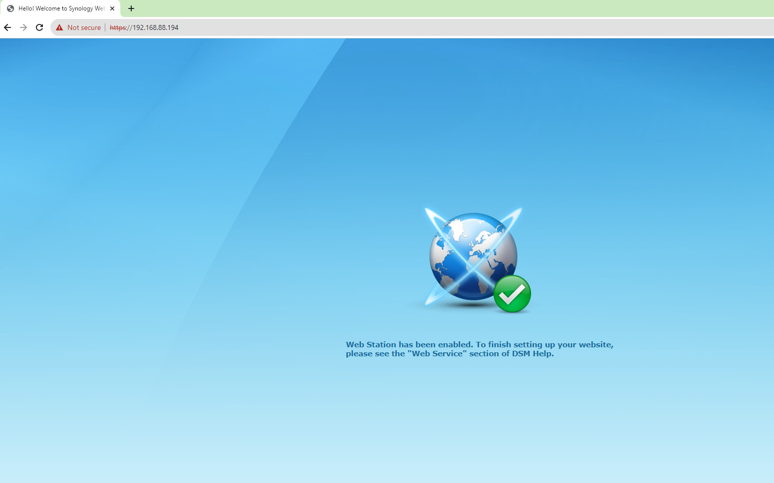

Okay so changing MTU to 1300 in Wireguard → Wireguard → (double click interface) → MTU appears to have fixed the problem. I dont really know what MTU does but that definitely seems to have been the problem given this remote laptop which hasn’t worked for months is now suddenly working. Thanks for the help guys!
