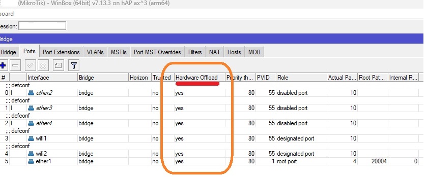

Not true, the AX3, has HW offload…

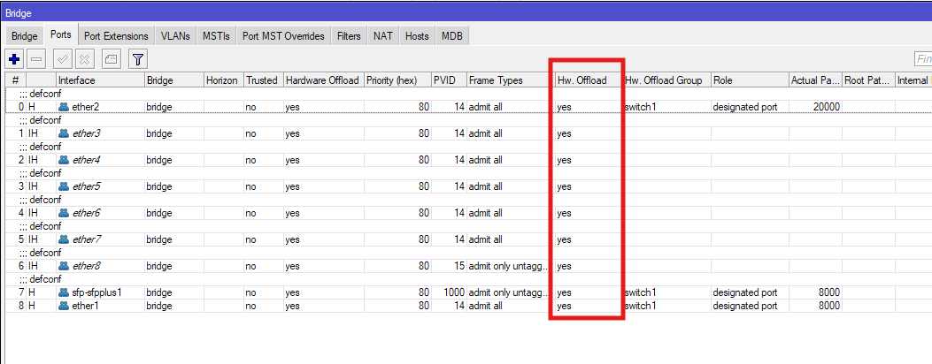

I think you are using the wrong column in your screenshot. The “Hardware Offload” column shows the value of the user-selectable setting checkbox. You have to make the “Hw. Offload” column visible instead, to see the real actual hardware acceleration state of the port:
Even without that column, you can see in your screenshot that there is no “H” flag on the 2nd column, compared to my screenshot.

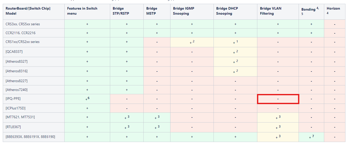

If we look at this page https://help.mikrotik.com/docs/display/ROS/Switch+Chip+Features, we’ll see that the hAP ax³ has the Switch-chip classified as “IPQ-PPE” for the 5 ethernet ports. And if we look at the Bridge Hardware Offloading table https://help.mikrotik.com/docs/display/ROS/Bridging+and+Switching#BridgingandSwitching-BridgeHardwareOffloading we’ll see that IPQ-PPE has no hardware supports for Bridge VLAN Filtering:
The number 6 in the table even has this remark attached to it:
Currently, HW offloaded bridge support for the IPQ-PPE switch chip is still a work in progress. We recommend using, the default, non-HW offloaded bridge (enabled RSTP).
So @loop has been right with his “software based VLAN” comment..
